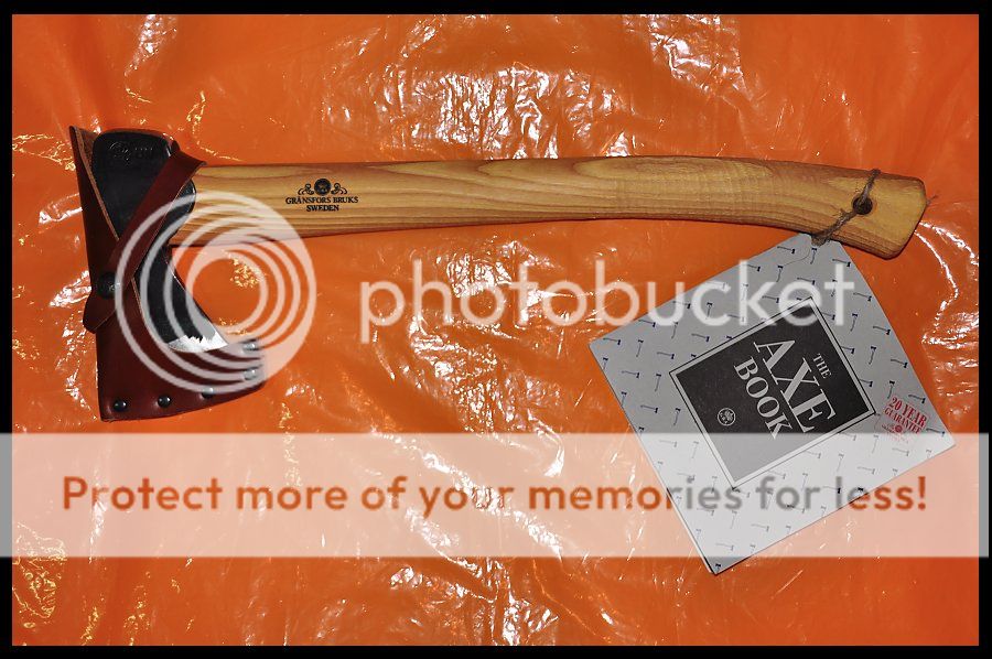

everytime i see someone looking for advice on which gb to buy it's inevitable that the small forest axe gets the recommendation...a distant second is the scandinavian forest axe (nematocyst and santacruz awhile back came up with the "scfa" shorthand so let's call it that). the hunter's axe never gets mentioned even though it's a lot closer to the sfa in size and weight than the scfa...i figured i'd find out first hand which is better so i bought both the sfa and hunter's.
the hunter's axe.
...knurled handle that's only on the lower 1/3rd of the handle.

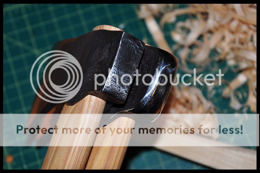

...the hunter's rounded poll next to the wildlife hatchet's poll (the scfa and the sfa's poll looks the same as the wildlife's).

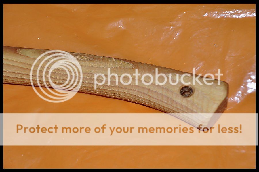

the hunter's handle is pretty straight and has a very hand-filling oval shape (the cross section) compared to the sfa & scfa's tear drop shape.

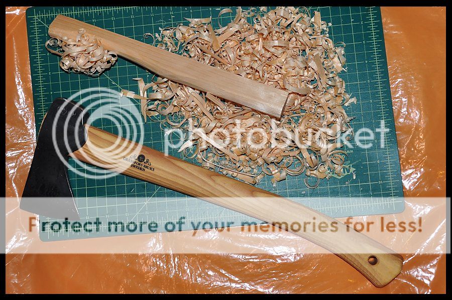

my first impression is this is by far the most comfortable handle to choke up on and do feathersticks out of all the gb axes i own (the others are wildlife, sfa, & scfa). the sfa and scfa's tear drop shape i find it creates a hotspot with my fingers.
also, opposite the pointy end of the tear-drop shape there's the hump on the sfa and scfa that creates a hotspot on my hand's webbing when choking up on that doesn't exist in the hunter's axe.
this is the first axe that i don't feel the need to carry a belt knife for feathersticks since it does it so well...feels very knife-like when choking up so it feels very comfortable to use to start a fire from chopping all the way to just before lighting the tinder.

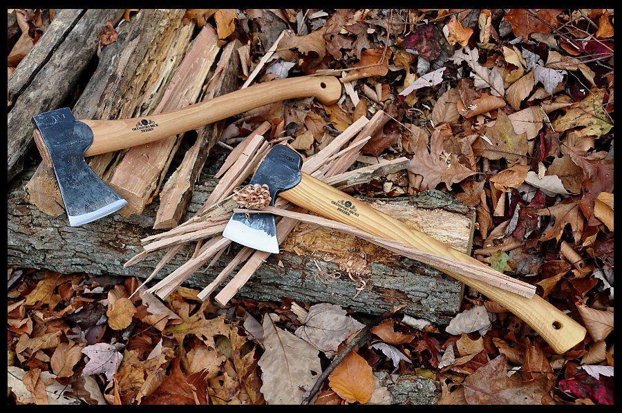

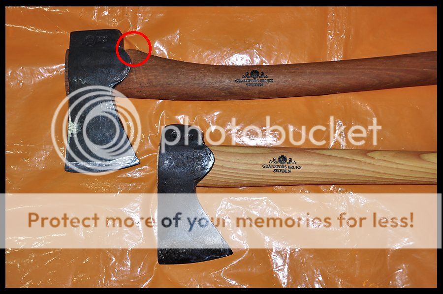

sfa on top, hunter's below.
clearly a much bigger difference than just the polished poll of the hunter's axe: different head shape and weight. also, the hunter's handle is slightly shorter and shaped very differently.
the hunter's axe (middle) is closer to the wildlife hatchet (bottom) than to the sfa.
the sfa (middle) is closer to the scandinavian forest axe (top) than to the hunter's.

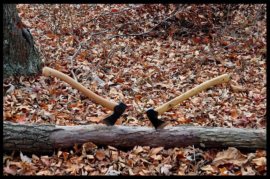

scfa and sfa.
hunter's and wildlife hatchet.
the pic's angle is weird but all the axes' handles' pommels are lined up.
my first impression is that the hunter's axe is a better design than the sfa...but if i can only have one axe i'll pick the scandinavian...two? i'll add the wildlife hatchet.

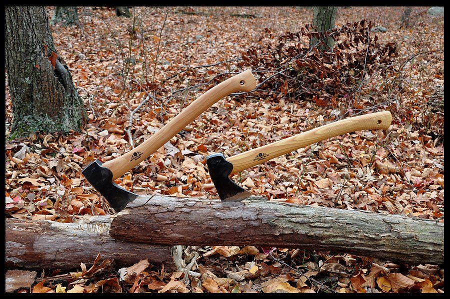

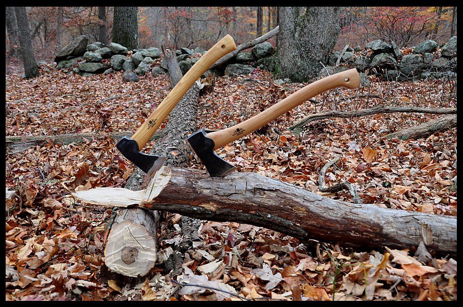

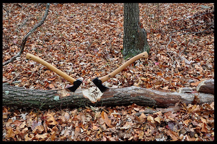

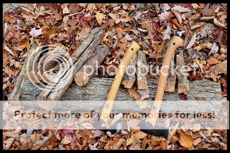

took a day hike last week to do an in-the-woods chop off...the full trip report here: http://www.bladeforums.com/forums/showthread.php/1123798-another-day-hike-axe-chop-off.
used this roughly 6" diameter dead fall (i think it's oak)...these two axes made me miss my scandinavian forest axe but my ocd wants a size between it and the wlidlife hatchet though...hence this chop off.
prior to this trip, the hunter's axe was ahead but chopping this log evened things out...the sfa's longer handle, heavier head, and mostly that hook-shaped pommel area felt better/more secure for me when i really wailed on it and put all my power into the chop.
i checked, both my legs are still intact and no blood anywhere (kidding...i followed proper axe technique and was kneeling down the whole time)...round two!
...i still preferred the sfa over the hunter when it came down to pure chopping.

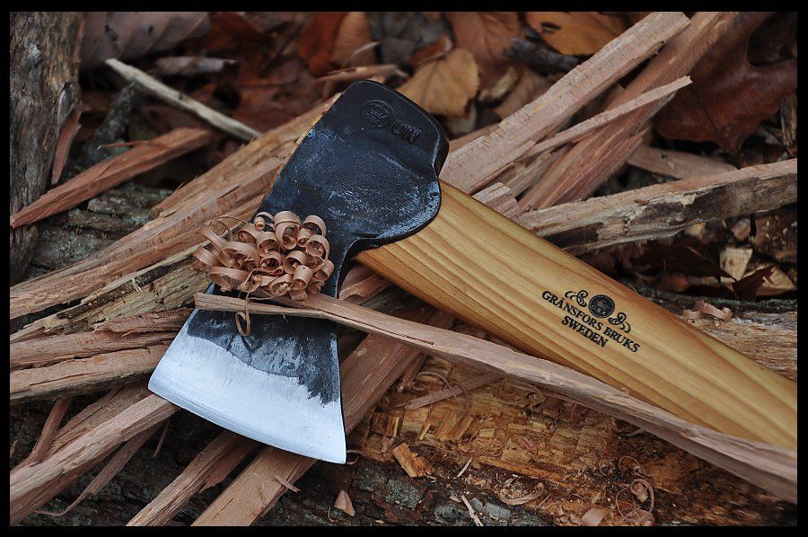

time to try the smaller stuff...held this piece vertical with one-hand (to prevent the axe from hitting the ground) and chopped one-handed...this is when the hunter's handle design shines - single-hand use like the wildlife hatchet but more power.
...splitting was about even.
when it came time to use the axe one-handed while holding the wood with the other hand to split kindling-size (see ray mears' axe video on the technique) then the hunter started to inch ahead again.
...and the hunter's more knife-like handle ergonomics pulls away when it came time to doing feathersticks...despite their similar handle length/head weight specs, they're very different axes in my experience...what i found is that for pure chopping and a belt knife to do the finesse stuff, i'll take the sfa...paired up with a folding saw and/or no knife at all, i'll take the hunter's axe.
