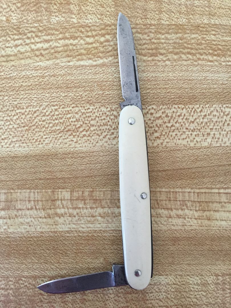

I do not have either of those knives, but have removed the bail from a couple of different knives. In both cases, I trimmed the pin and then peened it down because the blades developed play. This knife had a bail originally:
Thanks man. I ended up just snipping the bail down as far as I could get it to the pin, and then buffed everything smooth and shiny. Wanted to leave the pin for the structural integrity of the knife, and didn't want to peen.
