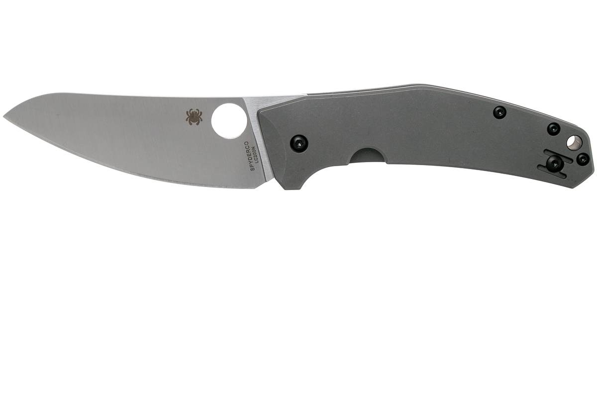

Thanks to one of the recommendations on this thread, I ended up buying a Spyderco Ikuchi.
For me, the main selling point of the Ikuchi is that it is very comfortable to hold in a "steak knife grip" for precise draw cuts on a flat surface (i.e., cutting board).
My general findings from this research are:
- The thinnest blade stock thickness that seems to be common is 0.09".
- Thickness behind the edge and grind angles are almost impossible to find.
- Not many folding knives seem to be designed for the steak knife grip (index finger on spine). It seems most are designed primarily for either a saber or hammer grip.

What are the best currently available light duty folding slicers in the 3.3 to 4.0 inch(ish) range that you have found? I am talking about knives intended to be used for effortless straight cuts through soft(ish) materials.
I have some heavier duty blades, which will also do light duty work. However, I am interested in getting a more specialized knife for fine slicing with minimal effort.
Some knives that have caught my attention, thus far:
TRM Atom:
- Blade Length: 3.5"
- Edge Length: 3.375"
- Blade Height: 1.125"
- Stock Thickness: .090"
- Thickness Behind Edge: ?
- Grind Type: High Flat
- Grind Angle: ?
Spyderco Native Chief:
- Blade Length: 4.08"
- Edge Length: 3.58" (91mm)
- Blade Height: ?
- Stock Thickness: 0.125" (3.2mm) w/ distal taper
- Grind Type: Full Flat
- Grind Angle: ?
Spyderco Spydiechef:
- Blade Length: 3.32" (84mm)
- Edge Length: 3.31" (84mm)
- Blade Height: ?
- Stock Thickness: 0.118" (3.0mm)
- Grind Angle: 4 deg
P.S. I generally prefer to hold my knives with my index finger on the spine for fine slicing tasks. So, I like generally gravitate towards designs with a flat(ish) spine. I also like designs that are relatively easy to use on a cutting board.

Check out the Spyderco Ikuchi, it's on the smaller side of your range, but its thin stock and small profile bakes it great for what you're looking for. It has a (very) slight up-swept Persian blade, a very fine tip, and a nice curving edge. I actually prefer using it with my finger on the spine, and because it's a slightly up-swept blade, it's really good on a cutting board.
