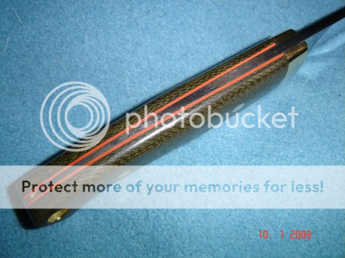

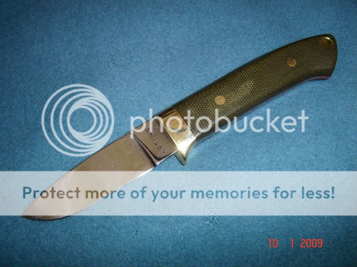

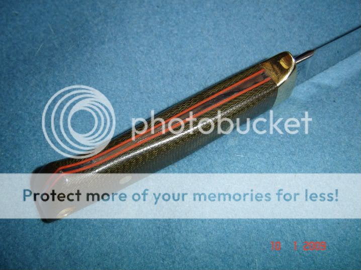

Just finished this one. Its been a bit of an experiment really, as I've just knocked up a 10" hollow grinding platen for my grinder.
This is 1/8" stock saw blade steel, 3 1/4" blade , 7" overall. Red fibre liners on tapered tang, with green Micarta.

It looks off balanced to me. Too short of a blade for the handle I just do not care for brass on knives..

I cannot see the point in making a using knife with a handle that doesnt fit in your hand. I can see your point that it would look better if the handle and blade were in proportion, but I'm sure anyone who uses a working knife daily as I do, will agree that one which fits the hand is far superior.
This is something like the 65th knife I've made. I started out with brass because it it easy to use. As I gain better skills I intend to use some other materials such as stainless.

nice clean work , great job on the tapered tang as well.
Brass works for me , a functional solid working knife. Nothing you don't need and everything you do.

Great looking knife. I'm not sure if those are scratches or not because it looks mirror polished. Sometimes the flash on the camera makes knives look like they have all kinds of blemishes that they really don't. My one suggestion, in order to rid yourself of the camera flash thing, is to light the picture with a different light source, then take the picture without the flash. I like the blade though. Good work. :thumbup:
I'm always having trouble with the photos I take. You spend time getting the finish where you want it, then when you photograph it, it looks like its been attacked with an angle grinder.
I've tried time and time again to take good photos, but in the end I get fed up and say "that will do". When I want some proper pictures done, I'll get Kam Singh to do it!

I thought it must be in the photo. Wouldn't make sense for a maker to go to so much effort to make such a fine knife to leave scratches on the finish.

This is why so many makers hate the lighting at many shows. It makes the blemishes stand out like you wouldn't believe. And one of the reasons the hand rubbed-satin finished blade has become so popular with the makers. You don't get this effect on a satin blade.
You can order the compound from K & G finishing supplies. 1-800-972-1192. Ask for the compound that Mike Lovett and SR. Johnson get from them. . It is the AB 300 white and SS 303 if I remember right. These will bring up the finish. To finish it off, use Pure Green. AGKG. Sheffield Knife Makers supply carries the pink no scratch which is in between the two, but doesn't get into stag like the pure green. Part # LEA8 . 1-800-874-7007. If you don't already have it, get a un-sewn soft muslin buff for the pure green and and keep it in a plastic bag to prevent contamination. They both sell the rake that you will need to use before applying it before final polish.

Thanks for the tip Mike. After reading that, it has just dawned on me how contaminated my buffing wheels are. I use a stitched wheel with fast cutting "cannings" compound, and a loose wheel with pink compound.
My workshop is 9' x 16' and contains everything, 2 belt grinders, 2 wheel grinders, 2 drill presses, band saw, 2 buffs, large forge, and my small forge. This is without all the countless other tools.
Needless to say, not enough room to swing a cat.
Even a small one!!
My buffing wheels must be full of steel dust, swarf etc and this is probably why I never seem to get a flawless mirror finish. They shine well enough to use as a mirror (when I figure you could use it to get something out of your eye with I'm happy) but always look rough when photographed.
It looks like clean wheels and green chrome is the way to go. Thanks.
