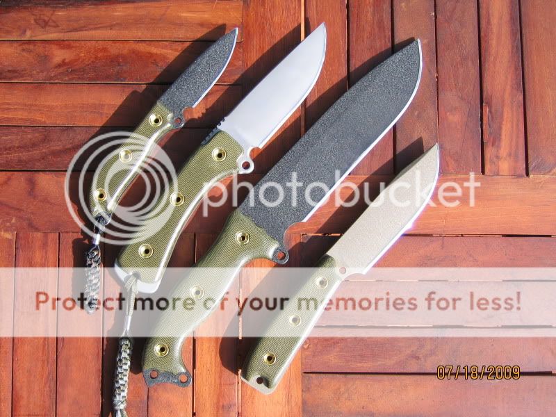

I made up some more Green Canvas Micarta slabs for my favorites. Man, do they feel good in the hand.

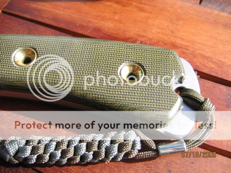

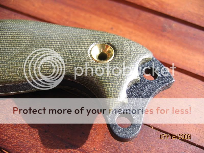

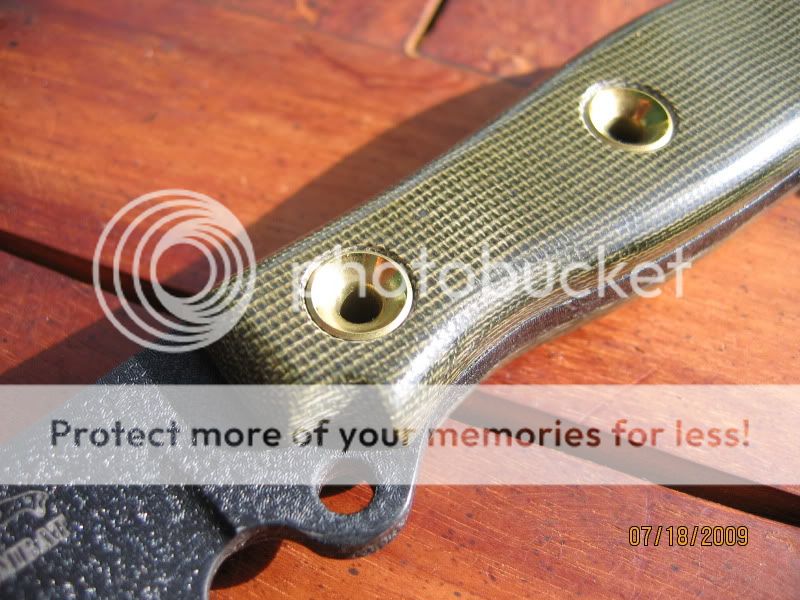

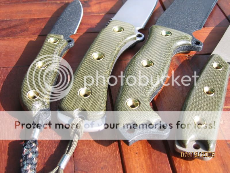

No glue - just the tubes. The tube diameter I use, together with that of the holes drilled in the handles and those I drill in the slabs, require a press to fit them. There is no play whatsoever and those handles sit really tight on the blade. I also use tubes with a wall thickness greater than that used by the shop.
