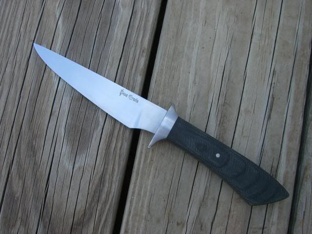

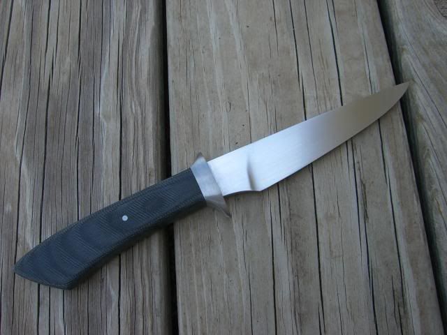

Blade : 6150 purchased from the back of a pickup at Tanehill (Batson's 08) - 5 3/16"
Fittings : 416 Stainless
Handle : Dark Olive Homemade Micarta
This blade was made night when a cousin of mine was visiting. I'd asked if he wanted to go play with the forge and he said sure, so we forged out a couple of blades using these 6150 bars I bought at Batson's. Was interesting a s the bars already had a bit of a taper in them already. So I kinda guided him along in forging a blade, finished mine up, his still has the tang to draw out. He enjoyed it though and now plans to build his own forge to play with. I decided to go ahead and finish mine up.
Put a set of my homemade micarta scales on it. It's a dark olive, I've got some of the cloth too, but just looking at the handle it almost has a blueish tint to it. Not sure why as it's green. Turned out quite good though. Back end of the handle tapers down to about 5 1/16" where it's about 11/16" at the guard. Starts tapering about mid way, feels nice in hand. What's neat is where the scales were glued together, you can't see the line. Blends very well, Just took the flats to a rough grit, fairly fibery, and then epoxied together, I think using slow set. I'd previously also drilled and chiseled the mortise out.
