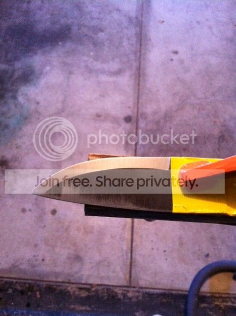

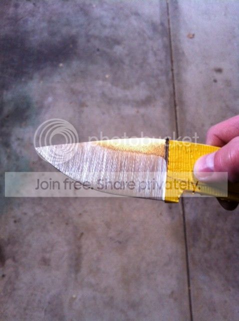

Alright guys, trying my hand at a few knives, got a pattern I really like. Even bought a kmg ;)
I had an idea to set the platen at a certain angle, then clamp the blade to a 1x1 piece of oak about 12" long. Keeping pressure the same, the angle is the same, however the grinds are completely different.
Pictures are better
this was one side, and sort of the goal right now
This is the other side, and what I would eventually like to accomplish, but dont know how to replicate it.
What am I doing wrong guys, I eliminated all variables, and two different grinds.
Thanks for your time
Well. not to be nasty but think of this. If you had eliminated all the variables both sides would have ended up being the same. No after saying that, I see you have a very even grind on both sides but the angle is just a bit less on the short side. Try for an adjustment . Not much is needed. If it was that simple, anyone could buy a machine, and you did get a good one, and make great knives right to begin with. The very small changes that are sometimes needed can be very dificult to know without lots of practical repetition. Staty with it. I believe you have made a fine start ! Frank

Your Oak just insn't perfectly flat and square I would guess. The other possibility is that your stock isn't flat and straight. Check the stock on the table of one of your tools, or on a surface plate. The Oak needs to be squared flatened, and have the side you're using squared up. Then you have to be sure to put the flat side down and the clamp the blade to the square side. Keep at it. If the jig isn't working, give freehanding the bad side a shot. Then, chock it up to learning and try again.

You are on the learning curve, we all have a strong and weak side when grinding and with practice and lots of patients your work will improve. Check your grind often, look at the grind and compare it to the other side and make adjustments as you go. Keep the blade moving fluidly with each pass on the grinder to prevent uneven grinds and dimples from developing. Like others have said, and from what your pics are showing you should try grinding freehand. Grinding freehand gives you more latitude in making adjustments to the angle of your grind.

I would guess that either something moved slightly. Or your wood block is slightly warped or out of square. Also I second the support for Fred's bubble jig. Currently using it for a full flat grind chopper that has a 10 inch blade, 2 inches tall, and 1/4 thick. Grinds are looking super even so far.
