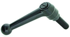

While we're on the subject, is there some easy elegant solution I'm un-aware of to allow really quick rotation adjustment of the multiplaten? I mean other than loosening a bolt with a rachet, and then cranking it back down after you rotate? Preferably something that doesn't involve tools.
Is there some solution to allow really quick rotation adjustment of the multi-platen other than loosening a bolt with a ratchet, and then cranking it back down after you rotate? Preferably something that doesn't involve tools.
Indexable clamping Lever
Male and female, many SAE sizes, many colours and styles including billiard ball type - fairly reasonably priced in sizes under 1/2"
http://www.fastenal.com/web/products/detail.ex?sku=3125593&ucst=t
