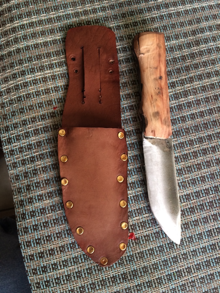

Indeed he did. It can be done however. I have since built a 2x72, but this is the last knife i made on my 1x30 harbor freight $30 belt grinder. It the 6th knife I ever made. I have no previous machining or metal working experience. In fact, before I started making knives I didn't own a file. What I DID do however, was come do a lot of research and reading, and came to bladeforums knifemakers section, humble and hat in hand to seek advice. I then LISTENED to the advice and tried to implement it to the best of my abilities. That is all.

Thus is a beautiful blade! Sorry to bring us off topic, but I just had to say that. :-)
