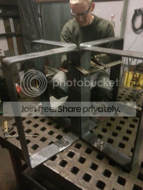

A black smith friend of mine has decided to take his knife makin hobby to the next level. He is doing his grinding on a slow moving water cooled stone wheel and was blown a way by my bevels made on a 1"×30" grinder. He has fully equiped shop but as all traditional craftsmen he is struggeling to make ends meet. He is not so tech savy and has asked me to find som plans for a grinder. Ive trided to search te forum for plans but did not strike gold.
Im thinking of a 2" belt 1hp motor and a flat grinding surface.
Are there any tried and tested plans that are out there?
Pic of the shop below.
Anybody know about any plans using metric measurement?
