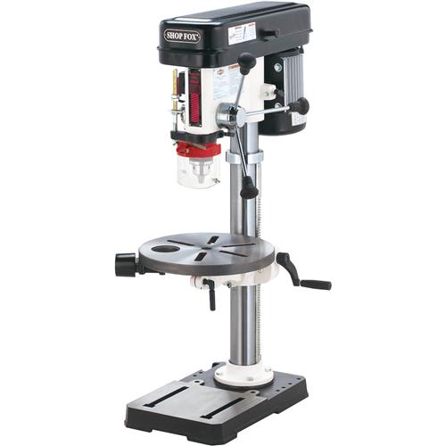

also, i was looking around the Grizzly site and really like the looks of this little guy:
Specifications:
  • Motor: 3/4 H.P. 110V, 1725 RPM
  • Overall height: 38"
  • Spindle travel: 3-1/4"
  • Swing: 13-1/4"
  • Drill chuck: 1/64"-5/8" (1-16mm)
  • Number of speeds: 12
  • Range of speeds: 12(250-3050 RPM)
  • Table: Round 12-3/8" Dia.
  • Table swing: 360°
  • Approx. shipping weight: 127 lbs.
either that or their radial drill press
Another essential tool! I have Grizzlys and some Harbor Freight stuff. The little 1x30 Harbor Freight belt sander is great for sharpening and they are cheap.
would a small milling machine be a better choice than a drill press?
sorry to keep bothering you guys with these questions, but this whole new world of tools has opened up that I know almost nothing about.
No problem Alan. I would go with the drill press. A milling machine would be really nice for folders
