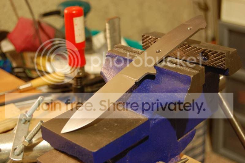

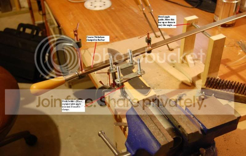

I think that the hand tool method is not too bad if you use jig like mentioned. This is the kind of setup I used - very simple and you can really get your back into it and hog off steel fairly fast.
I wanted to get a cheap grinder andle grinder etc but I was surprised that the jig worked so well so I decided to keep saving for a KMG.
I have since simplified this jig a little but the concept is still the same. The important thing is not to vary the angle when flipping the knife for the second bevel.
Here's my first. Still not finished unfortunately.:o
Very nice pics Amp, thanks for sharing. Knife is looking good... Get to finishing it, I'd like to see how it turns out :thumbup:
Are you using the jig to get the rough profile of the bevel then draw-filing or using the jig the whole way through?
