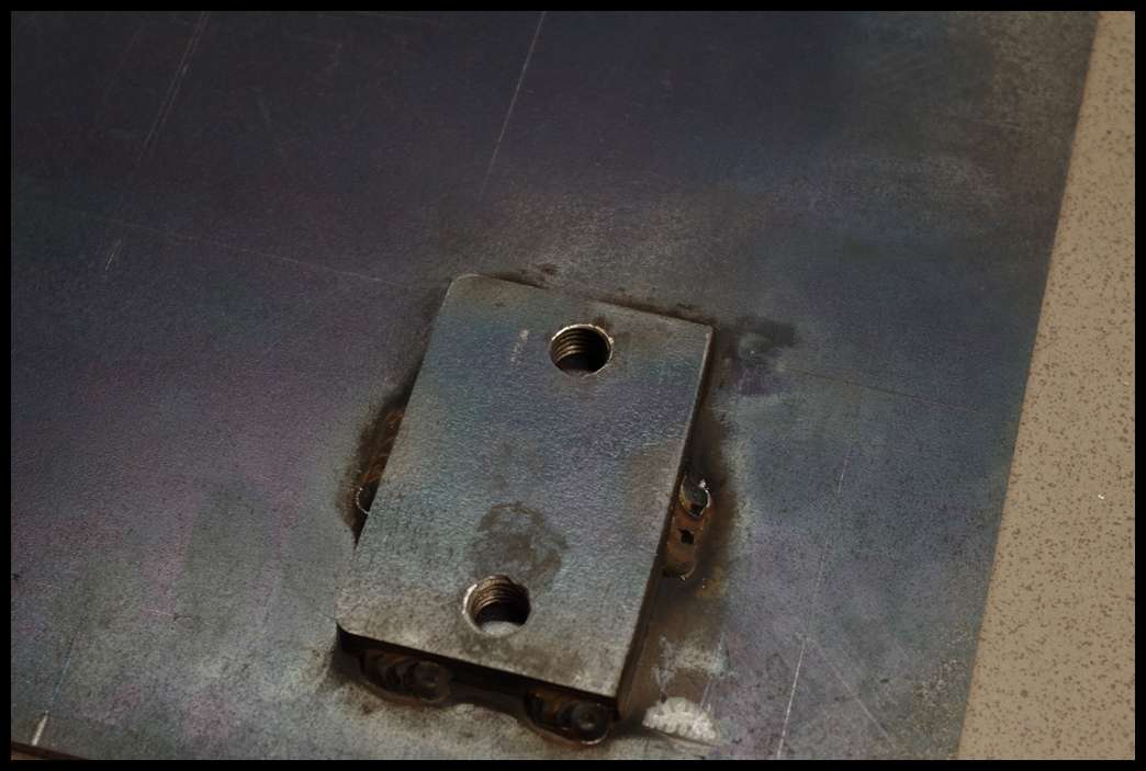

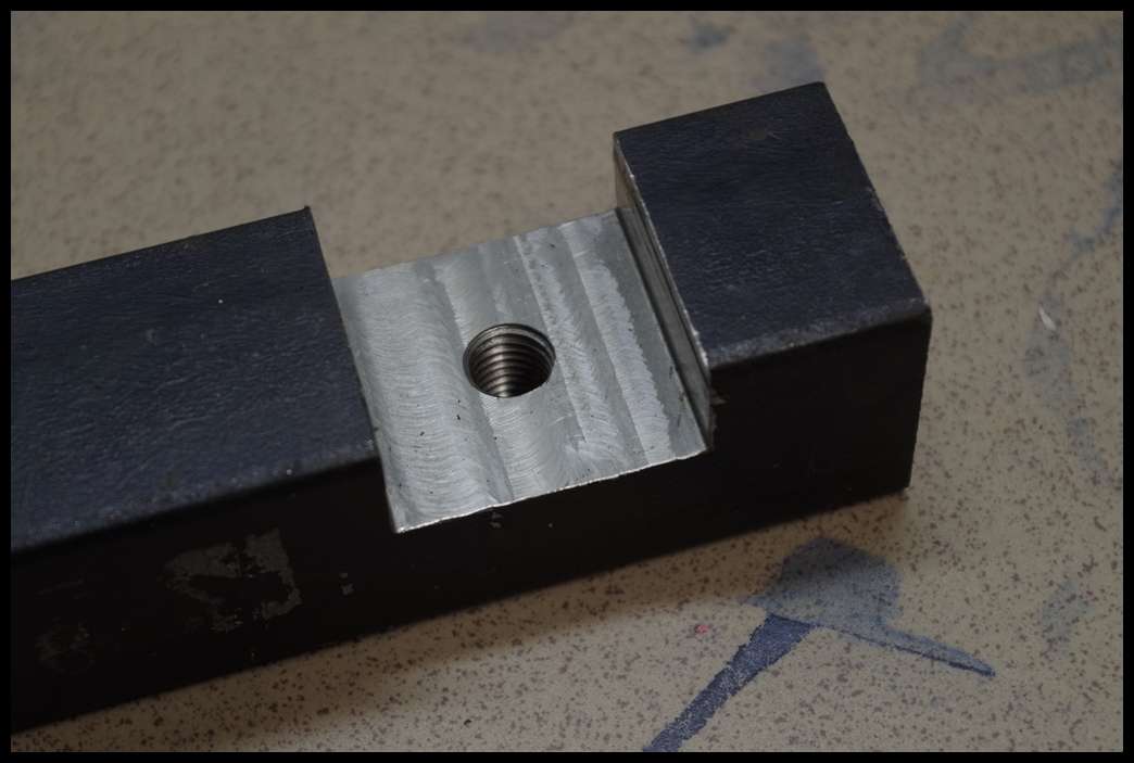

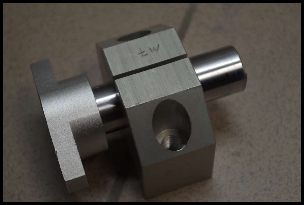

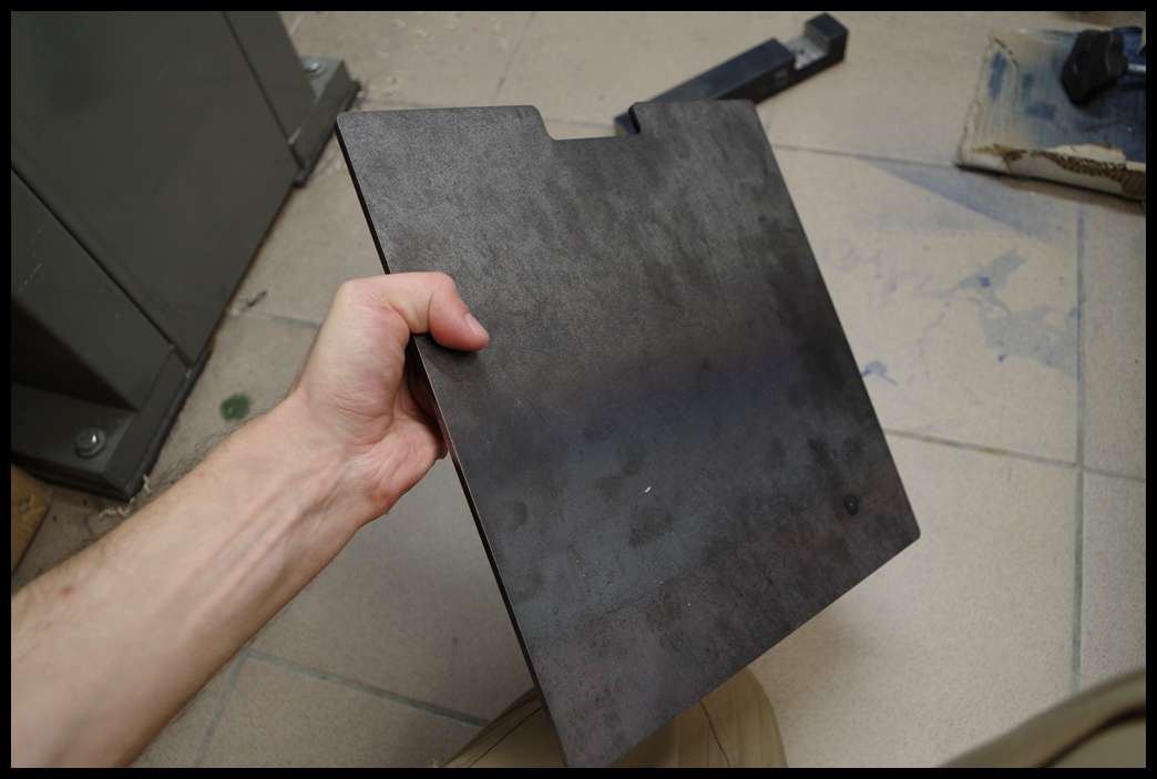

OK, I ordered parts for new work-tables ;)
1. for extreme small angles ( for making tanto tips and nice swedges )
2. For making angle started grinds ;)
Power wiilll RIIISEEE :D

By the time I was thinking about work rest for making tanto and swedges, and there he is :P
I just need to mill mounting do grinder arm.
