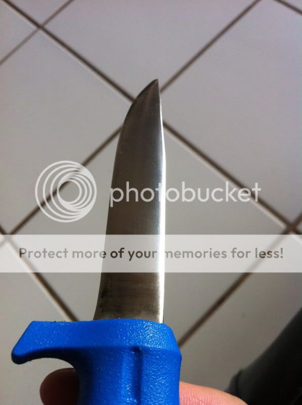

Finished a few days ago but never got around to posting it. So I figure after I finished an 8 hour shift from midnight to 8 in the morning and sleep deprived would be as good a time as any:thumbup:.
Here's the knife in question:
Burned the tip a bit(which subsequently chipped off later on):
Finished!:

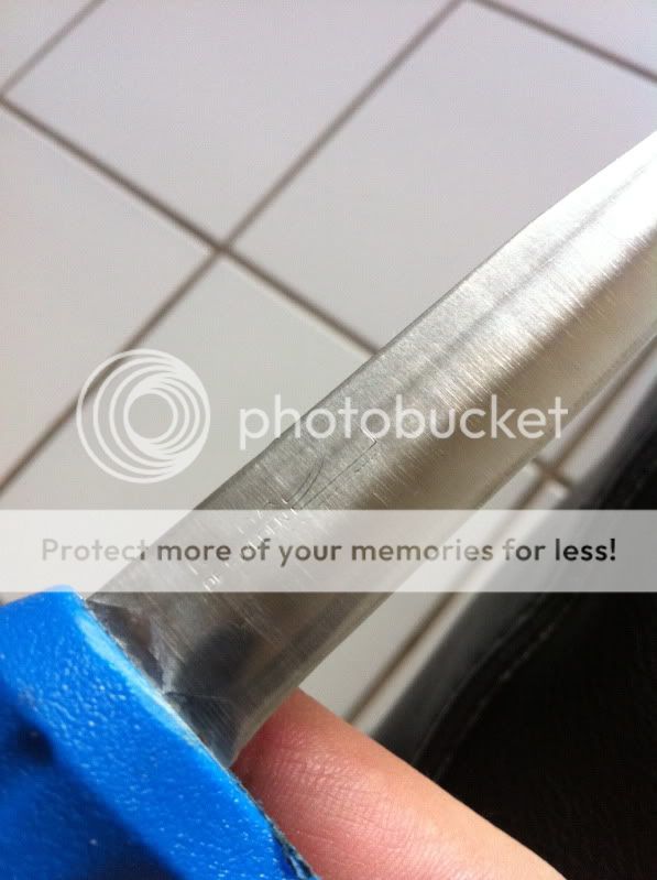

I've noticed that if you drag the very tip of the knife off the belt, it'll burn easily. But if you pull it off just shy of the tip, then it rarely even sparks. So that last 1/4" from the tip should be left for much finer belts(finer than P220). Another thing I noted was that my P220 belt seemed to leave much more coarse grind lines than my P80, which meant I was using a really worn out belt this whole time:grumpy:.
Not a bad first try. Didn't screw much up aside from the tip. I also just got in 5 Norton 40 grit ceramic belts and about 30 Zirconia Alumina 60 grit belts(messed up on the ordering there), so that ought to speed up and complicate future attempts. I've ordered a Kershaw Needs Work as the guinea pig knife, mostly because I figure edge retention is a step up from AUS-8 in the Cold Steel Mini Tuff.

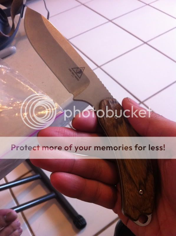

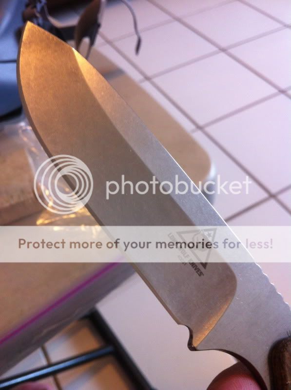

I wanted to break in my new belts and had my eye on my Lone Wolf "cheapie"(like $50 cheap:rolleyes:).
Had a little compatibility issue when I had to shove the belt in and sparks went flying when I turned the machine on. Turns out the belt was a little more than twice as thick as my other belts. Like a good monkey, I went and brute forced a solution by holding it on until either the plastic or the abrasive was worn down:thumbup:.
The belt(which was 40 grit and not the 60 I had thought) worked great. It ate up the steel in a hurry and didn't seem to heat it up any more than my P80.

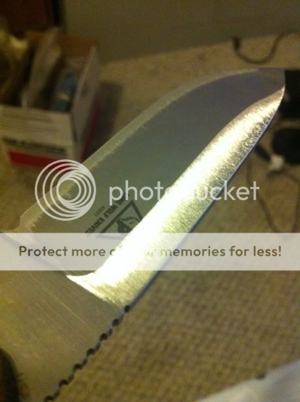

I did run into a little snag here:
Note to self:
Don't try to regrind a hollow ground blade:thumbdn:. I won't have anymore suitable candidates until the Needs Work gets in the mail. If that works out well I might give a try on a Spyderco Lum or Caly3 in ZDP. Though I might pass on regrinding the tip on those and just try to blend the grind lines in since harder steels would tend to leave me with a broken tip.
Hmm, the needs work is hollow ground as well, so I won't get anywhere unless I severely thin out the spine as well:grumpy:.

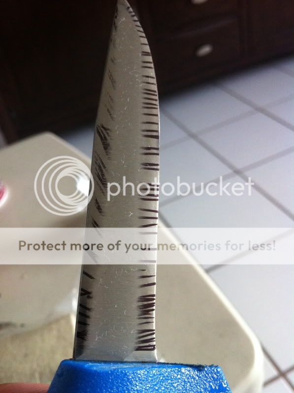

I'm on a roll!!! I felt like giving my Mora another go with a very light touch since it didn't feel thin enough. Turns out it wasn't necessary to use a featherlight touch since the belt is too thick to flex much.
I have to say though, my new belt is amazing. It eats up metal like crazy(I only noticed when I felt metallic dust all over my arms, chest, and legs). I only hope I didn't inhale too much dust before putting on that filtration mask I've been neglecting. Heat doesn't seem to be a problem so long as I don't mash the blade against the belt.
Overall I'm looking forward to using this bad boy at work tomorrow:thumbup:. Also have to wonder if there's a market for super thin ground folders:D. Wouldn't trust myself to regrind someone else's knife, but I wonder if people would buy knives that I bought and reground.
The reground Mora cut my Braeburn apple without splitting it, which is an improvement. Didn't get to use it at work, so I'm not sure how it does slicing other things.
