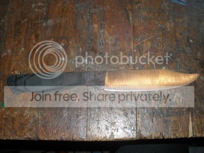

I'm incredibly far away from "mastering" making knives. In fact I haven't even completed my first yet. However I can attest to the Bubble Jig. I used it the first time to get the grinds on my first forged piece. I got what I felt were 2 perfect grinds on it first time using it. They're symmetrical and flat and a helluva lot better than I'd ever do freehand at this stage of the game. I didn't cut the plunge lines in yet though because I didn't want to push my luck :D
