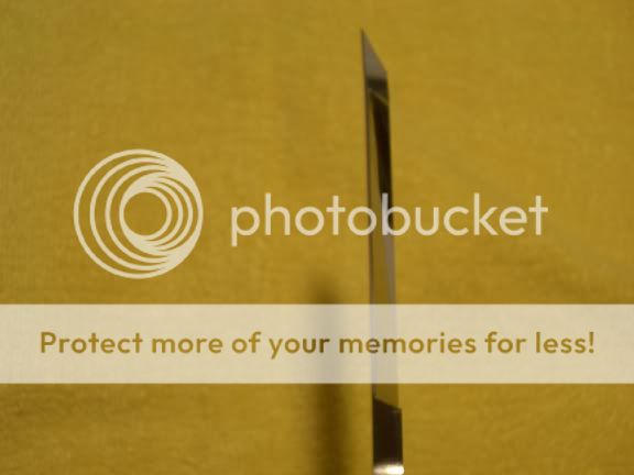

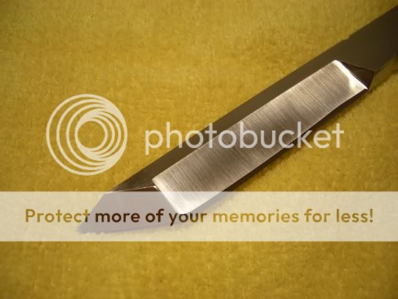

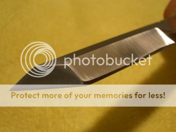

Hmmmm I wonder if anyone has tried a hollow chisel grind? I'm sure they have but it sounds like something I'd do ;)
Randg, Not to hijack your thread but,Dan wanted to see:) :) :) Just did this one yesterday. 1/4" 01, 4" blade x 3/4 wide. First time hollow grinding. I tried to keep it simple. Nice strong tip, shaves nicely. Its a good sticker!
Shawn
I think that's with in topic:)
interesting,,:) thank you..
make sure you show the finished product when done..:thumbup:

Will do. Kinda my attempt at one of those fancy new-fangle grids you see on some striders and Elishewits'. Shawn
