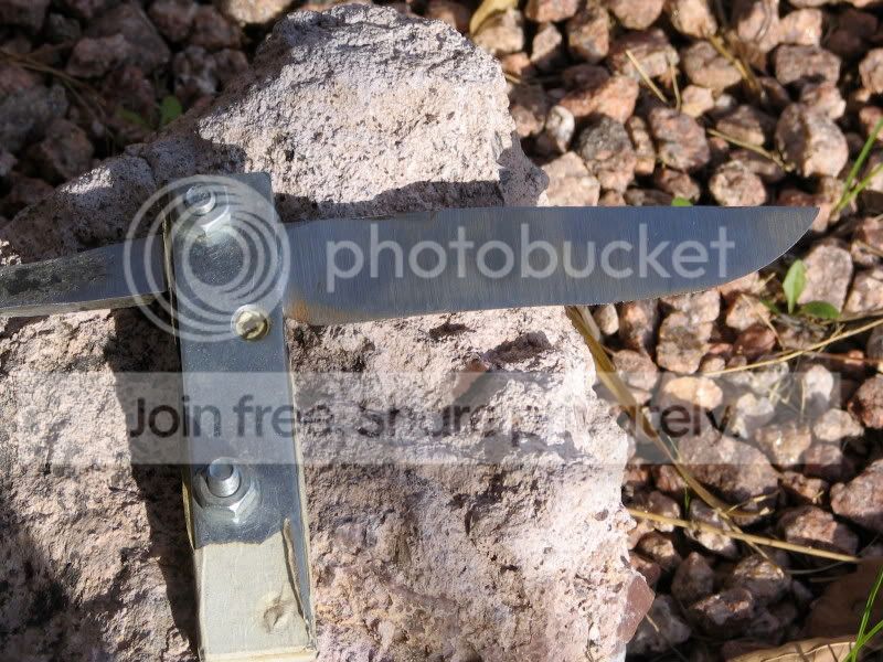

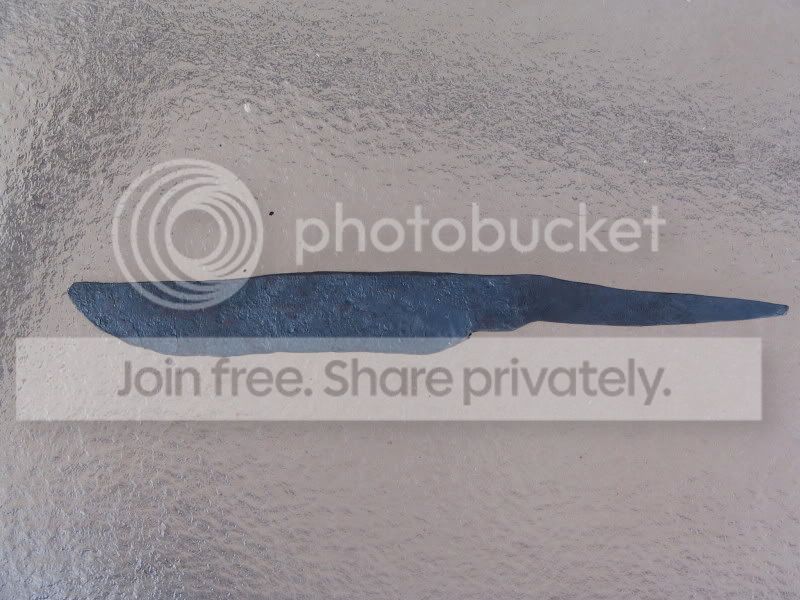

Here is what I started with:

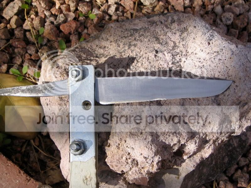

This is from last night...this side isn't too bad:

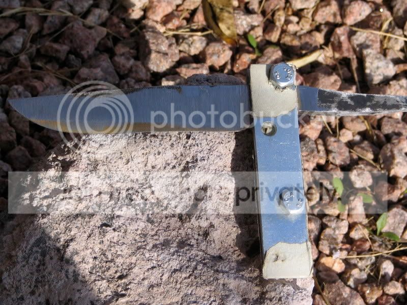

This side is more of a mess, both grind-wise and hammer mark-wise:

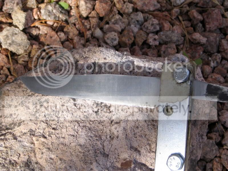

Here it is 'fixed' from this morning (and I haven't even ground the edge back yet, so you can see I've lost quite a bit of the blade):
other side for posterity:
