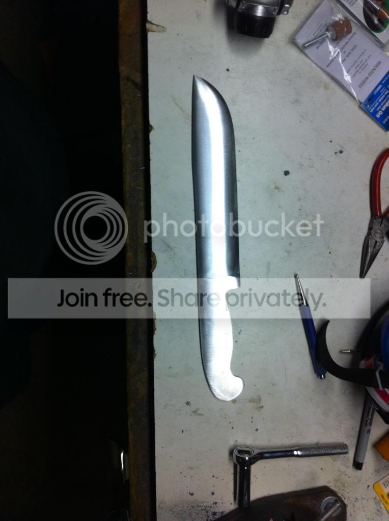

So I've run into a problem with my grinding setup. The jig I made works great with smaller blades as the belly on most of them has been shallower. Here is the kind of jig I am using:
http://bushcraftusa.com/forum/showthread.php/81426-Scandi-Grinding-Jig-Tutorial
I have this big chopper in the jig and when I drag it across the belt it works great until I reach the belly. My question is, what is the best way to consistently grind the bevel while using this jig? The way I see it I have two options.
#1: The first would be to rotate the handle clockwise and down so the belly curves along the belt. This wouldn't work with the jig as the tool rest/table is in the way of the clockwise path. I'd prefer to use the jig if at all possible.
#2: The second would be to pull the handle towards me so that the edge would stay in contact with the belt throughout the belly. I have my grinder and tool rest/table setup now to do this. I just want to make sure this will cause any undesirable effects on my grind.
I know there are a lot of free hand purists on here and I think that's awesome, I just get more consistent results from using the jig.

Oh and BTW I got the bevels most of the way done on my big chopper. I just pulled the handle towards me so that the edge stayed on contact throughout the belly. Worked pretty good. I still have to blend everything together but that should be done here in a little bit. I'll post pics when it's done.
Just got the bevels done. I ended up just convexing it at the end blending everything together with 120grit. I don't know if I'll go any higher than that before heat treat. Anyway here is my 2nd knife:
9.75in blade, 2in wide, 3/16in thick.
Kind of a shitty picture, sorry.
I'm pretty sure it's ready for heat treat aside from drilling pin holes. If anyone has advice as to what size holes I should drill and what size pins I should use I would appreciate it.

On a big chopper, use heavy size pins. 1/4" would be my suggestion. Drill the tang holes a bit larger than the pin/rivet. You want to drill the tang hole at least 25% larger than the rivet to allow some alignment slop ( If you drill them the same size as the rivet, it is almost a guarantee that the pins/rivets won't want to go thorough the tang during assembly).
Personally, on that knife I would use three large size Corby bolt ( 5/16" head) and drill the tang holes at 1/4". That would provide a solid handle and a good look. You would need the matching counterbore to the Corby bolt size you use.

Actually the rest was far from custom and was made using two pieces of angled aluminum. It works fine while grinding the belly, all I had to do was pull the handle towards myself once the belt comes in contact with the belt. I'm real happy with how things turned out. I blended everything together at the end freehand but that was easy with a slack belt/no platen.
