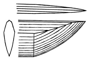

That sharp angle is a secondary point intended for quick flick of the wrist "Slash Stabs" and is called a Yokote, and I'd just sharpen it as if it was a regular drop point with regular belly, it'll eventually wear away to be curved.
That portion is called the Yokote but authentic Japanes tantos aren't ground so sharp & abruptly. It's more of an Americanized version. Just sayin.. :)
Yeah; it should be noted that a yokote is not common on tantos, and is far more common on swords. it is essentially done by shaping to a rounded curve, and then by final grinding and polishing making it almost but not quite a facet. in a tanto, this would be a shinogi-zukuri. much of the reason it looks so pronounced in those blades is due to a different degree/type of polish. notice in this image as an extreme example; there is a continuous single curvature to the edge, even into the kissaki:
http://www.nihonto.ca/yukimitsu-2/tokuju.jpg
the yokote is not the tip, but the crisp transition between the kissaki and the nagassa.
I'm only a layman of course. this is only as I assume to understand it.
