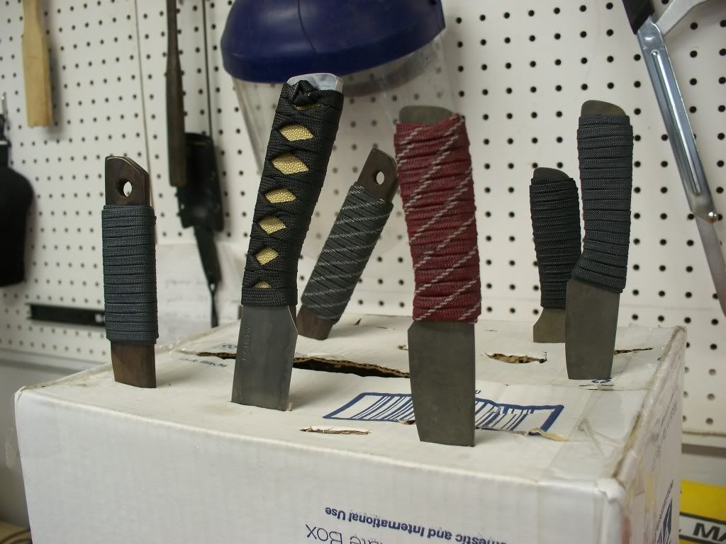

I did the cord wrap today along with some other ones, these are all epoxy soaked and drying as I write this.
The photo is horrible! Shop light lighting... will get better ones later.
That's black cord over cream colored rayskin on the fighter, there is a gem grade dinosaur bone menuki on the back. I cut and polished the menuki myself from local area dinosaur bone.
