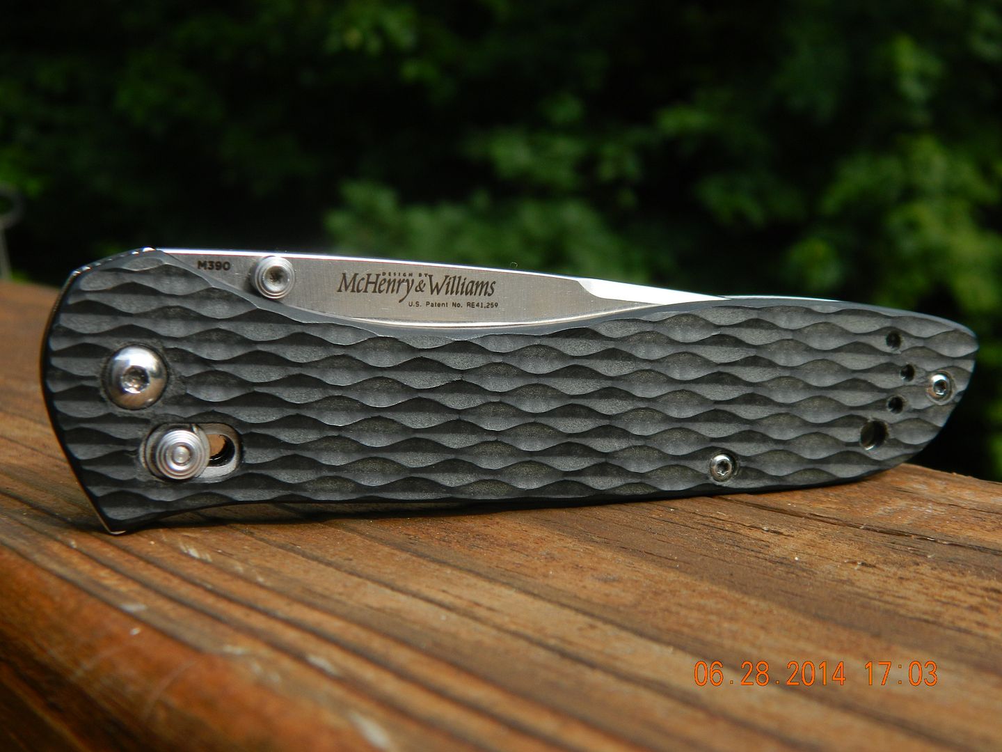

I've got a 710-1 in M390 and it's my favorite knife. I like the look of the plain black G10 scales just fine but I wish they had a "grippier" texture similar to the new Axis Strykers.
Any suggestions?

Good point. Sorry. Easy might be adding anzo style grooves or similar with a Dremel to save $.
I really want the same factory shape, thickness, etc. just in a grippier G10. The factory scales are a tab bit too slick. I would consider maybe a different groove pattern.
Coarse peelply with standoffs?
It's a 707, but you get the idea.
