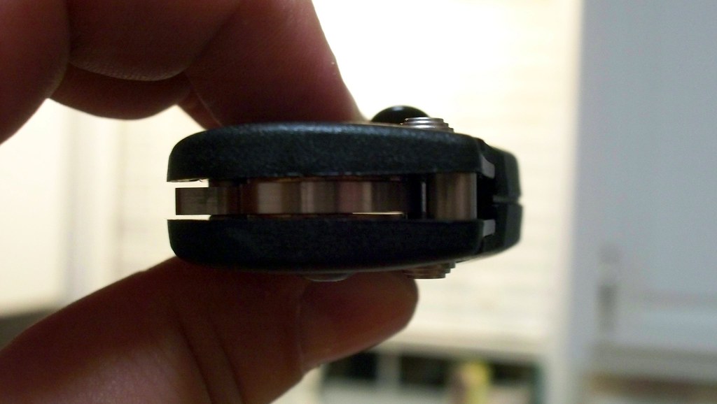

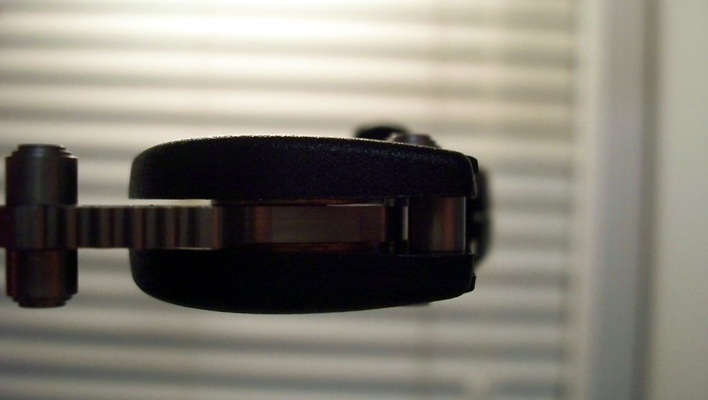

So I buy a Griptilian a few months ago, and no matter how I try to tune the pivot I can't find that sweet spot that gives you a free swinging blade with no play. Upon close inspection I notice the washers are not laying flat against the blades. There is a visible gap between the blade/washer, and the washer/liner on both washers, but only between the pivot and the stop pin. Like the stop pin is too wide so when you tighten the pivot the liners look more like this, \/ rather than this, ||.
So I send it off to Benchmade explaining what I found, two weeks later I get it back saying they replaced the liners, stop pin, washers, and screws. Well, what I get back is better. No gap between the washers and liners, but still showing a gap between the washers and blade.
Here are two photos showing the gaps the best I could (I couldn't get one pic showing both at the same time without holding the knife too far from the camera):
This is my second or third Grip, and i don't know how many Axis lock knives I have owned, and I don't remember seeing this before. Anyone else have this issue? Obviously I can try warranty repair again, but maybe there is a trick to fix this? I have tried all the screw loosening and re-tightening tricks I know to try and center a blade, but none of that has helped at all.
That is strange: it indeed looks like either washers or the blade itself is thinner than they should be by design... I guess a simple fix would be to add thin washer or find a set of thicker ones . That would not explain the phenomena though, only help to improve the performance.

I'd send it back to BM with those pics.

Looks like the washers aren't ground flat, which is just completely unacceptable. I'd recommend sending it back and calling them about it first as well. But yeah, they need to make this right.

The second BM556 that I have is perfect. The difference is... the blade thickness. The perfect one's blade is slightly thicker. But I gave up and haven't discussed it with BM service - I live in Europe and I don't want to sent the knife to the USA and I believe they will not send me a spare blade.
Interesting, i haven't seen that yet, but i see what you're talking about. And with them replacing everything but the blade pretty much, i wonder if it's the blades not ground evenly at the pivot area?
It's the stop pin. It's a tiiiny bit to long.
Had the same problem on mine. I took it apart and very carfully filed it down. Not a easy mod but it's doable.
EDIT: It's more likely the blade thickness, but the mod will fix the problem if you are unable/unwilling to send the knife in.

I had 3 mini grips, 2 were perfect, 1 like the OP's. I took them all apart, and measured everything, the liners, washers, stop pin, blade, etc. All measured the same except the blade. Like cali, the troubled knife had a slightly thinner blade than the other 2.
Did you measure your parts compared to a known good knife? I suspect you just compensated for a thin blade, which is fine.

But filing down the edges that rest against the liners on the stop pin fixed it.

I saw a vid where the guy said it was because the stop pin is not seated all the way. Squeezing the liners together where the stop pin is will pop it in.

Then it is the stop pin or the washers.
It's a pretty easy fix if you just have a drill, calipers, a clamp or two to make the drill stationary and a small file.
Measure the thickness of liners, washers and blade put together. Then measure the liners with the stop pin in between. The two should ideally be the same in a perfect world.. But in this case(and my case) they are not.
Now you secure the stop pin into the drill and set it at low speed. Very carefully shave off some of the material, on the shoulders only(the surface resting against the liners), of the pin. Then go back to measure.
After some back and forth you should get there soon enough, just be carefull not to take to much of, you'll end up with a pin rattling BM.
Now your knife is rock solid, no play.. :cool::thumbsup:
