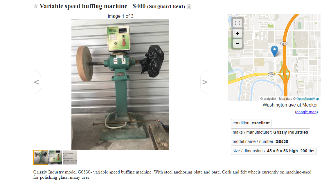

Hey guys,
So before I go run out and buy this buffing wheel (like i did with the bandsaw that can only cut wood :p) I'd like to check with you guys and make sure it's good to go. Obviously the big name in industrial 10 inch buffing wheels is Baldor, but I've always seen Grizzly be respected for their machines also (besides their fixed speed 2x72. ). Anyway, found this on craigslist... the G0530, in what looks to be good working order. I'm having a hard time finding an MSRP or original sales price to know if it's a good deal or not... but it seems like one considering it comes with the stand. What do you guys think? Here are some pics and stats, including a link to the full owners manual:
http://cdn0.grizzly.com/manuals/g0530_m.pdf
So what do you think, should i ask if I can show up with $350 cash and come pick it up today? :cool:

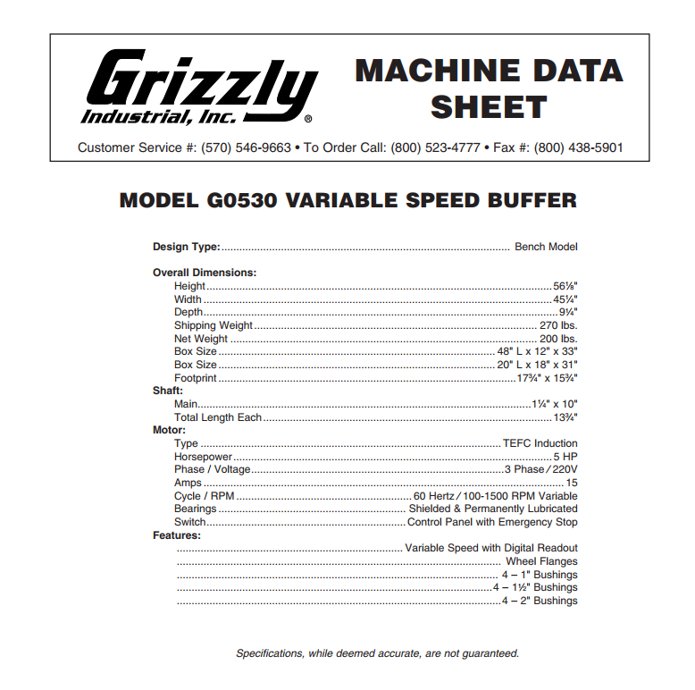

Note that it is a variable speed from 100-1500... is this enough? I've seen most Baldors list either 1850 or 3500ish
Actually I think that's a heck of a deal. And the reason most smaller buffers are faster is they're running smaller wheels and therefore need more RPM for higher surface speeds, and many guys think they're too fast at that.
It appears to have a VFD that's 3 phase in, 3 phase out however. Which means you likely can't run it as is.
Thanks for responding so quickly as always, Kuraki. Can you explain to me what the problem is in laymans terms? From setting up my vfd on the grinder I can see the difference is a 1 phase in and 3 phase in... Does this mean it would need to be plugged into an outlet running off a 3-pole breaker? I asked the seller what kind of plug she had it wired to and she said a standard 3 plug 220v... I currently have that kind of plug wired to a 2-pole breaker and could probable rewire it without too much trouble...
No. It would likely mean replacing the VFD with one that's like the one on your grinder. I say likely because for some reason I think there are some VFDs that can manage single phase in or three phase in, and the difference is just how you wire them. But it would take the manual or someone more knowledgeable than me to say whether that's the case with the one on that buffer. I assume it's not capable of that, since the data sheet you posted lists the machine as three phase only.

Well the the lady just reached out and beat the number in my head before I could ask... $275 out the door if I can get it before the end of the month so she can get rid of the storage unit. She said she also has a kiln but I'm assuming it's for glass... I've done some preliminary research on HT ovens and have seen that companies like evenheat make both smaller knife and larger glass/clay kilns... wondering if a big one would work for knives also? I asked her what kiln it is...

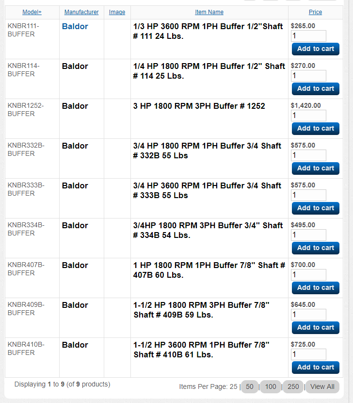

Speaking of trugrit, here are the selections they have:
I see the 1.5hp 3600 you mentioned there at the bottom for $725... I think 3/4hp 3600 for $575 is a bit more in my budget considering I still need to get the stand and wheels. Hoping I don't regret the 3/4 hp choice... talk me into spending the extra couple of hundred if I will really regret it! LOL! While I'd love to give trugrit more of my business as they have been great so far, I'm working on a budget, so if anyone knows of a retailer with better prices on buffers I'm all ears!

Trugrit is great, I deal with them a ton. It's cheaper for me to order a Baldor from them and get it shipped up than to buy one in Canada...
The 333b would probably be my recommendation. I really don't have a need for the 410 over it, I just like tools and want a bigger one. I have the 332b right now, and about the only time I slow it down is taking the 12" wheel. For what it's worth I was talking to Mike Stewart (bark River) the other day, and he has nothing but 3/4hp baldors for his buffers.

For $275 that's getting hard to refuse...
It is still on the slow side though. It'd be great for flat grinds, but very limited for hollow grinds
I would buy that for $275 and throw a $150 5hp Chinese VFD on it and buff everything into oblivion.

I almost forgot it's only 1500 rpm... Decisions... I think I've got all the info I need now. Big thanks to all of you. Now to bite the bullet and decide!
And to further add to myself, I'm more into flat and convex grinds than hollow anyway so that might not be the worst... ?
At that point if you mostly want to do flat grinds, and aren't much for mirrors I'd say go for it. And for mirroring flat grinds that thing would be hard to beat with an 18" buff.
You guys are forgetting you could run the thing at 120 hz and make it almost as fast as you want.
That machine, with an aftermarket VFD and 5hp on tap will do anything you could reasonably ask a buffer to do in a knife shop, IMO.
The deal is on... I am feeling very confident about this option as I just spent the past 2 weeks wiring and troubleshooting the VFD for my grinder. There is no set of poorly translated chinese instructions that can stop me now!!
