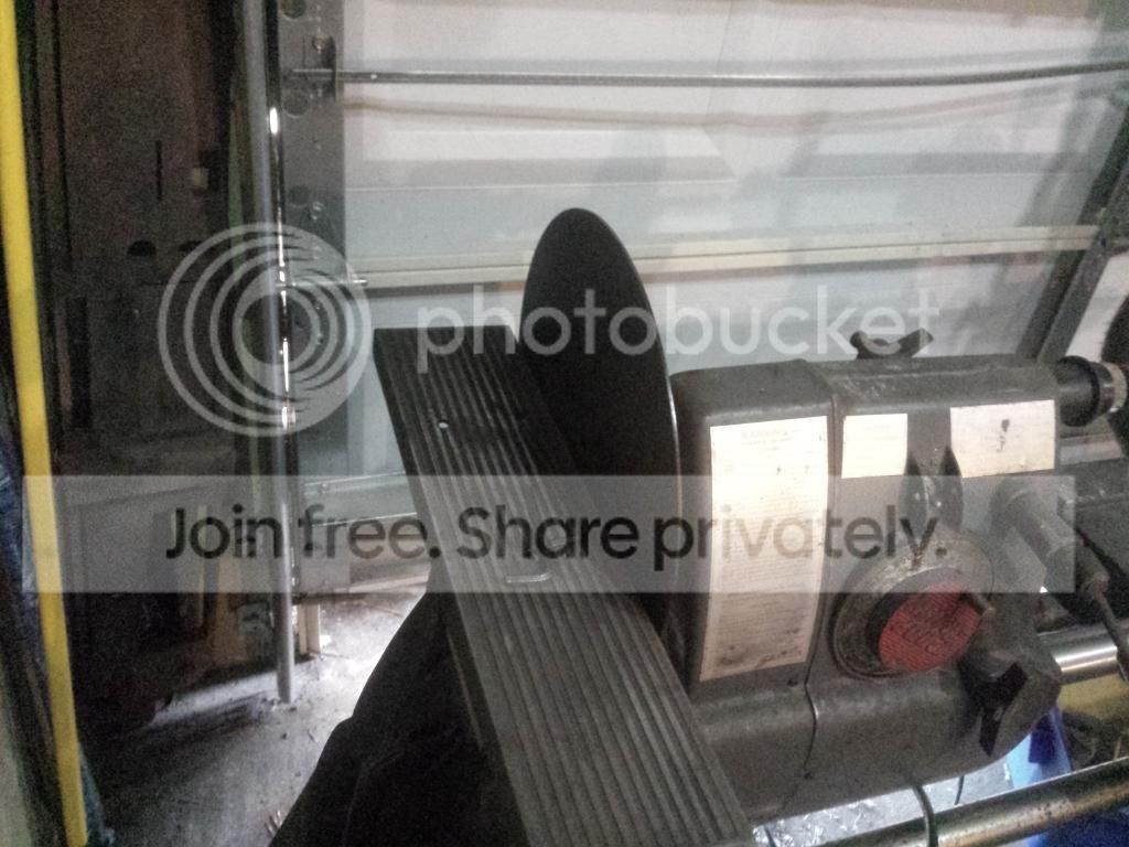

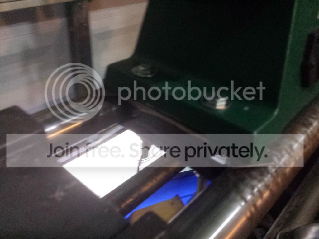

ok so ive been brainstorming for over a year on the best way to modify my grizzly to variable speed, then it hit me, i have an extra shopsmith, thats a 1 1/8HP motor with a 5/8" shaft and variable speed from 500RPM-10k RPM
here is the results
all it took was a lovejoy coupling, some angle iron, and a few 25 thousandth motor base shims.
VARIABLE SPEED ROCKS!!!!!
That is really good thinking....no bearing side load and more mass in the "spin train". Excelent mod.
thanks Stacy, it really works well, shimming it in for alignment I only needed 2 shims, its like they were made to go together, also I now have a disc sander
