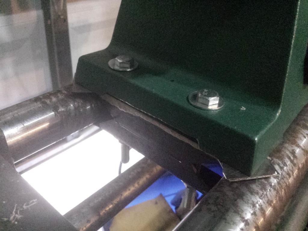

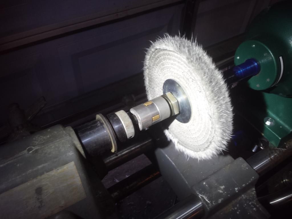

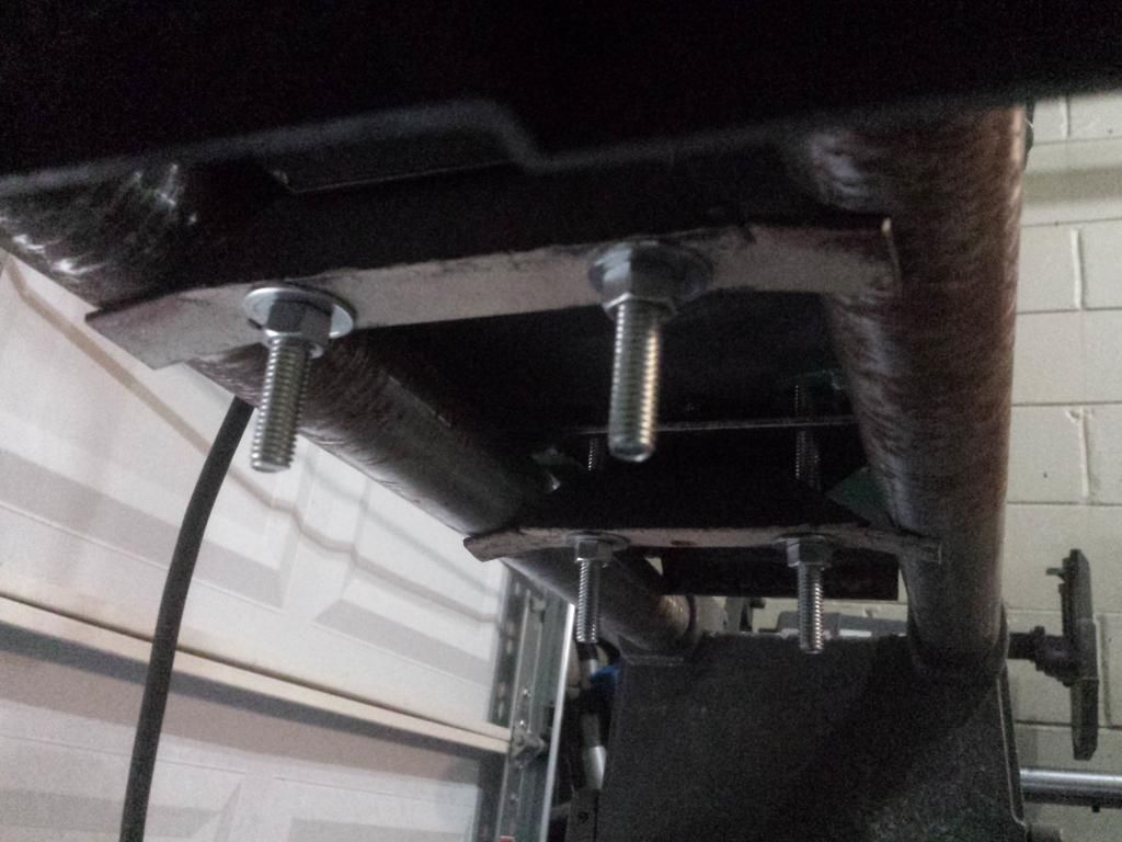

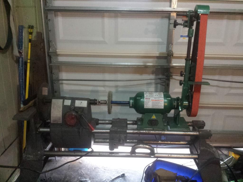

I combined mine with a cheap shopsmith off Craigslist for variable speed. A few shims under the grizzly and a lovejoy coupling on the shaft. It gets the job done until I can afford something better

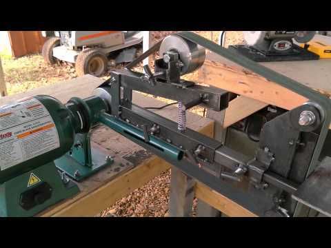

This is what I'm working on now.
