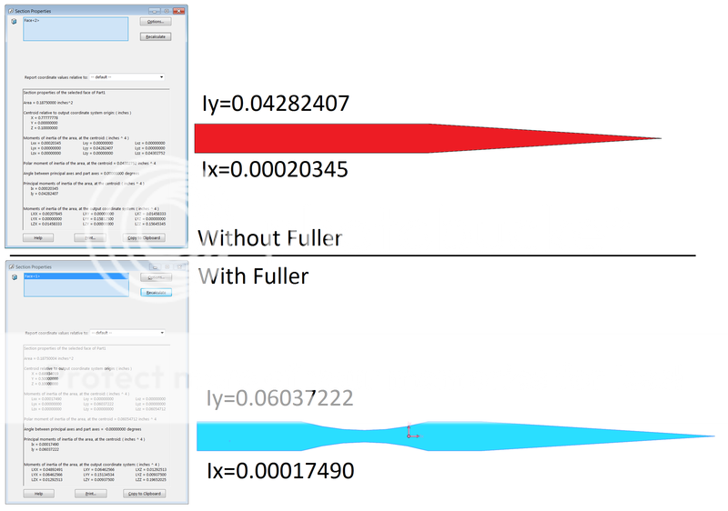

Any time you remove material from a solid, it is weakened and becomes less stiff. What you can do is move where the mass in s beams cross section is located to create "a stiffer beam per unit of weight". What this means is you can gave two beams that weigh a pound per foot and one can be stiffer than the other (it will have a higher I value, or Moment of Inertia, which generally means it has more of its mass located father from its centroid or axis of rotation when you look at a cross section). You cannot take a solid chunk of steel beam and cut ANYTHING out of it to make it stiffer.
Bottom line:
A blade can be made wider with a fuller added and be stiffer (in the direction off the edge/spine) than a less wide fuller-less blade that weighs the same amount. The issue here is most blades break perpendicular to the cutting axis (such as when you're prying) and a wider fullered blade has virtually no benefit to strength/stiffness in this direction. It can actually make the blade slightly less stiff in the prying direction....
