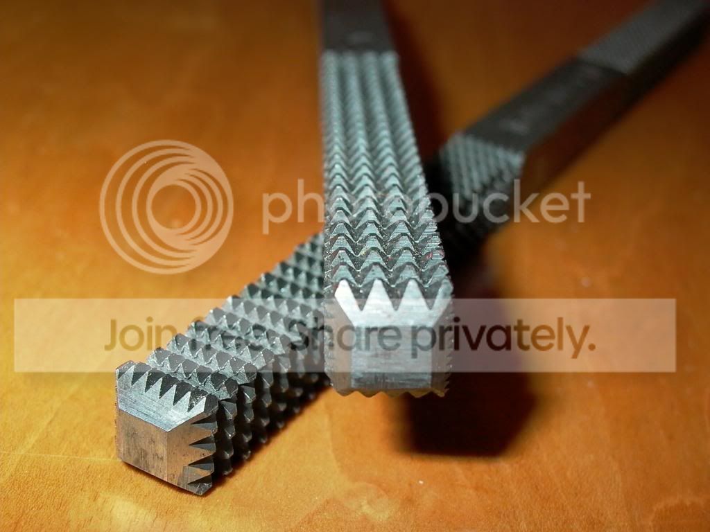

You could use a checkering tool/file as is used in gunsmith work. They work really well for doing checkering on a confined area, such as the frame of a pistol and the like, I don't see why you couldn't get the same results with a set of scales. Check Brownells, Midway, Cheaper than Dirt, etc... The grooves are usually pretty narrow though, might not get the same definition on micarta... They are sold in LPI (line per inch) increments. Is it affixed in such a way that treating it like a rehandle wouldn't work?

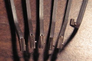

If you wanted to do checkering on the cheap, you could use a thread chaser file for Micarta or G10. Also a cheap pack of needle files would work for a lot of different patterns.
I have some cheap thread chasing files and they wouldn't cut beans.
Look at the burrs on the one on the left.
I'd like to try the Brownell's checkering files, but $ is not the same.
