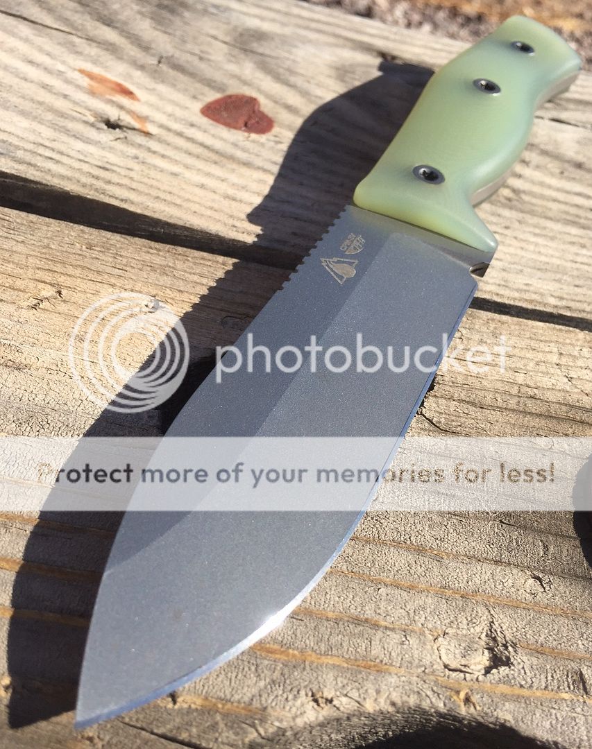

Today I had a chance to rework the factory edge with my wicked edge, cuts even better, if you can beleive it ;)
Did you stick with the factor edge angle?
Yes, it was about 22 on each side, and I kept the knife to the back of the W.E. (clamp jaws closer to the tip) to follow the factory angle all the way to the tip.
They may use a different angle, but 22 was where it line up on my Wicked Edge. Also my kit is the small one, and only goes to 600 grit... And it still shaves :)
Nice looking edge!
600 seems to be just about perfect for a nice working edge on these.
