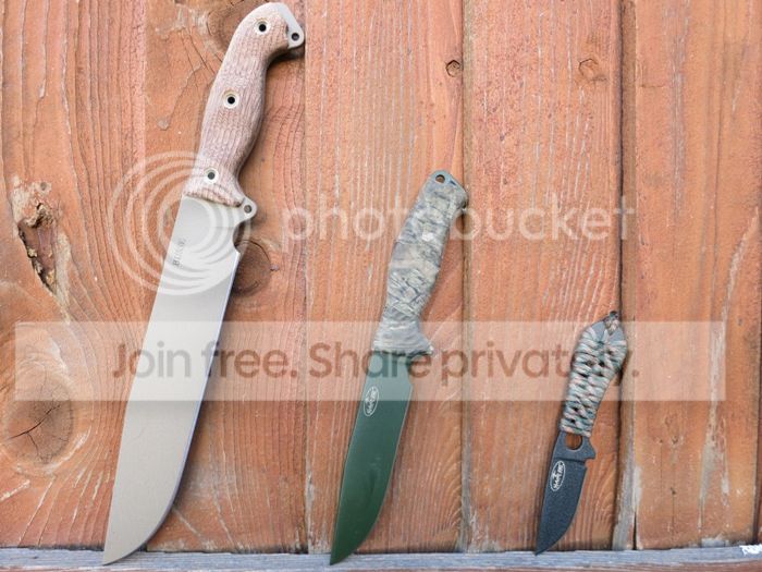

I agree, it's hard to beat the ergonomics on the RMD. Just don't buy one with the black paper scales. They look cool as hell but they are so slippery it defeats the whole purpose. I had to wrap mine in some camo tape to get some good grip. Should also mention mine is the Prototype version (full flat grind, slightly longer blade, but only came with the black paper handle) pictured in the center:

Nice pair!
However, the next GSO line up has redesigned handles....
That's a damn good lookin RMD.
Thanks guys! Don't mind my daughters pink shoe in the photo. No worries though, she has a pink Native 5 to go with it:
