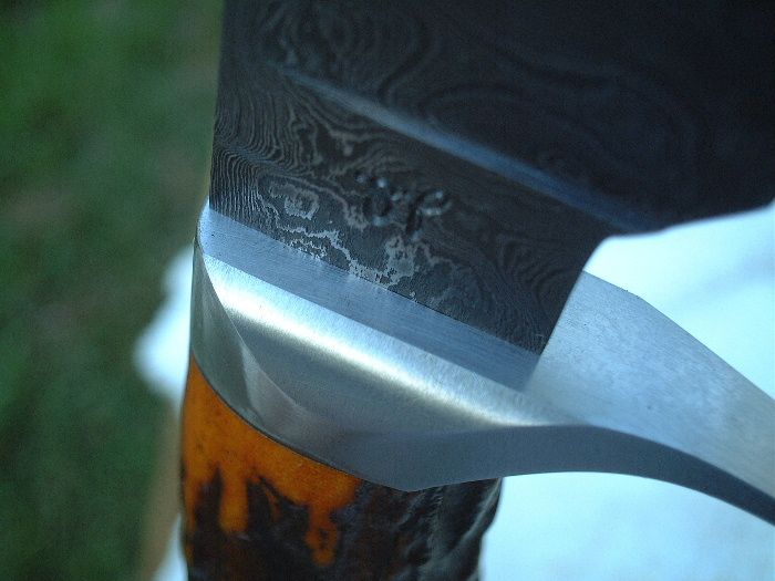

Seems I have a lot of questions lately, sorry. On the positive side I guess it means I finally have a bit of shop time. Plus you guys are so helpful. :thumbup:
On the last knife I made I went with a little deeper etch on the Damascus and I really like it. Downside is that it creates deeper depressions and even though they are still pretty shallow, it can show at a few places at the guard/tang junction. I don't see how to prevent this except by grinding a small shoulder on the flats of the tang.
How do you guys do it?
Painting the mated surfaces with nail polish as a resist before etching will assure these areas stay a perfect fit.

Somehow that just seems reverse logic to me.
I want the areas that won't be seen to be etched/removed MORE than the surrounding areas so they will be smaller. You want the guard slot smaller than the ricasso if possible.
I sand the area behind the ricasso right up to the sholders.

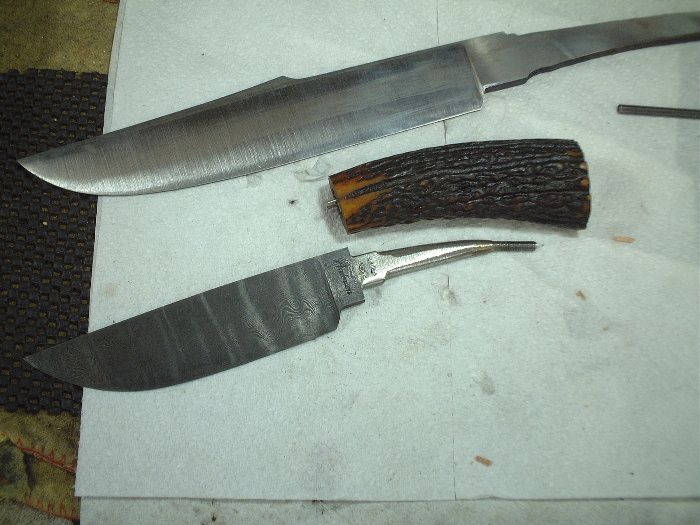

Like so:

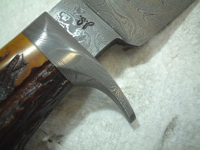

Here is a take-down stag, Patrice.

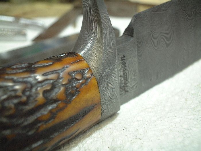

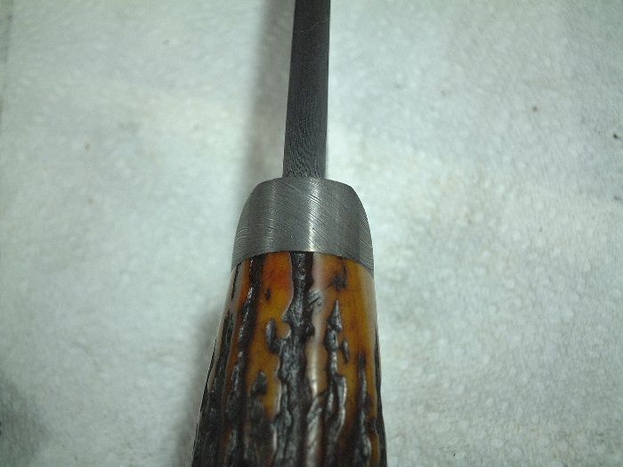

Not only a Damascus blade, but guard, as well.

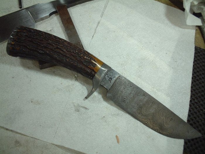

I etch my damascus usually 15 minutes four times - for a full hour. A really deep etch so I can do good hot-bluing contrast after sanding.
Here's the initial fit-up:

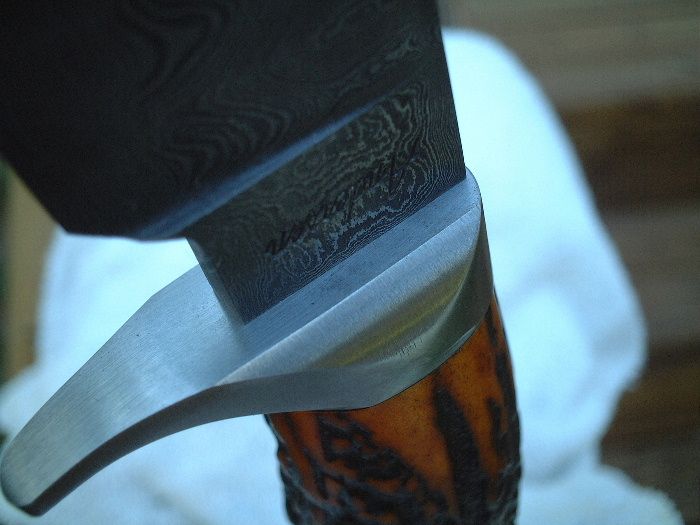

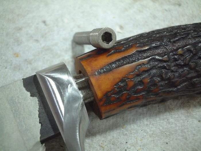

Get my assembly figured out:

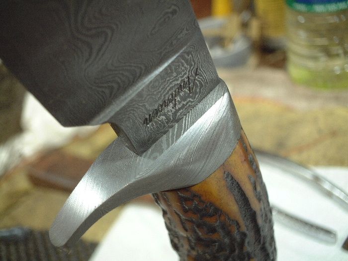

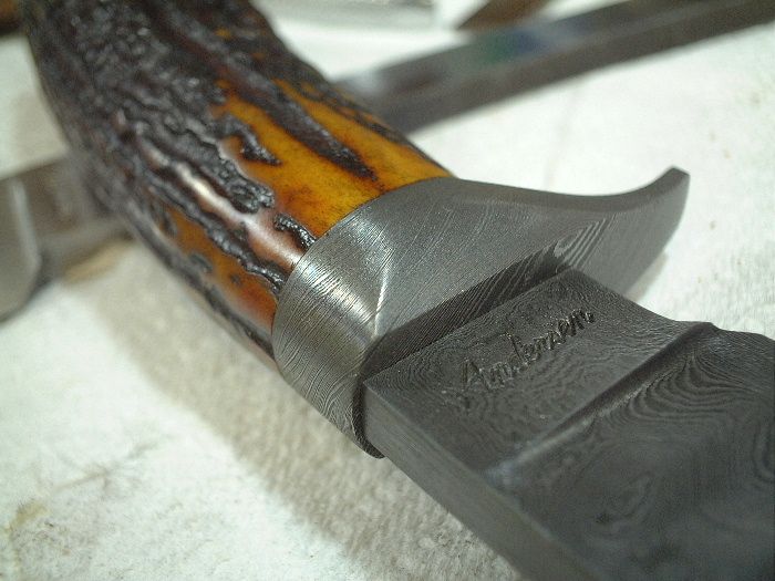

You can see here that I have sanded the area where the guard goes to be SMALLER than the ricasso. You could also do a careful resist on the rest of the knife and etch this area MORE!! - not less.
Then I etched the guard after all fit up and shaping was done.
