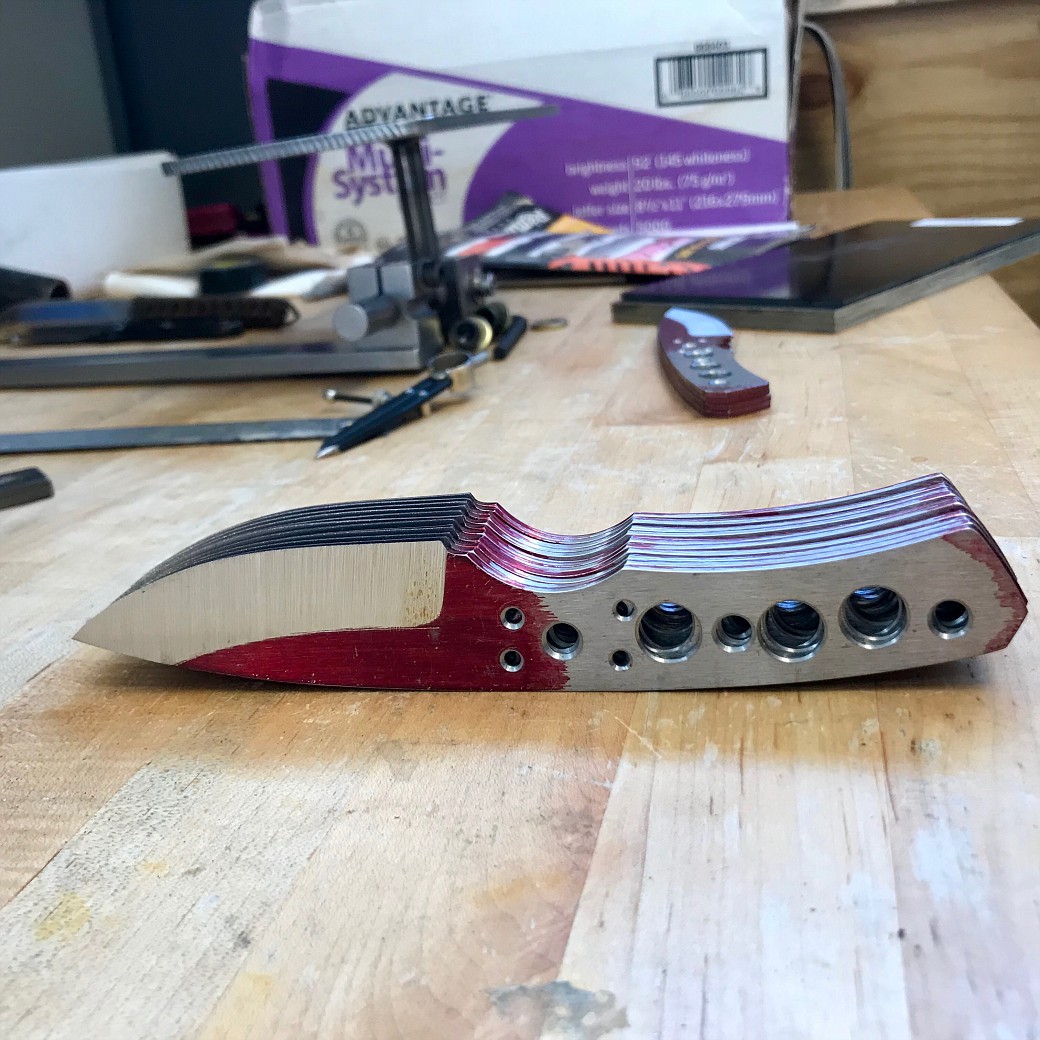

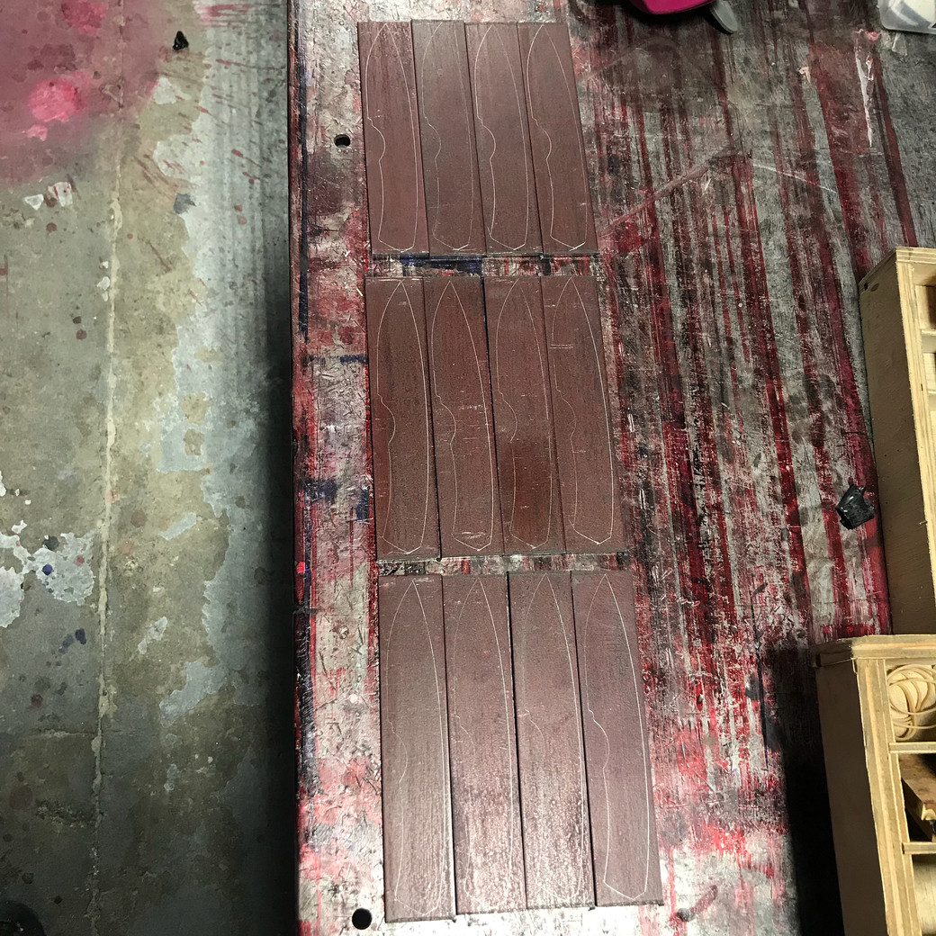

Here is the beginning stages of the Guardless Warthogs that are on pre-order

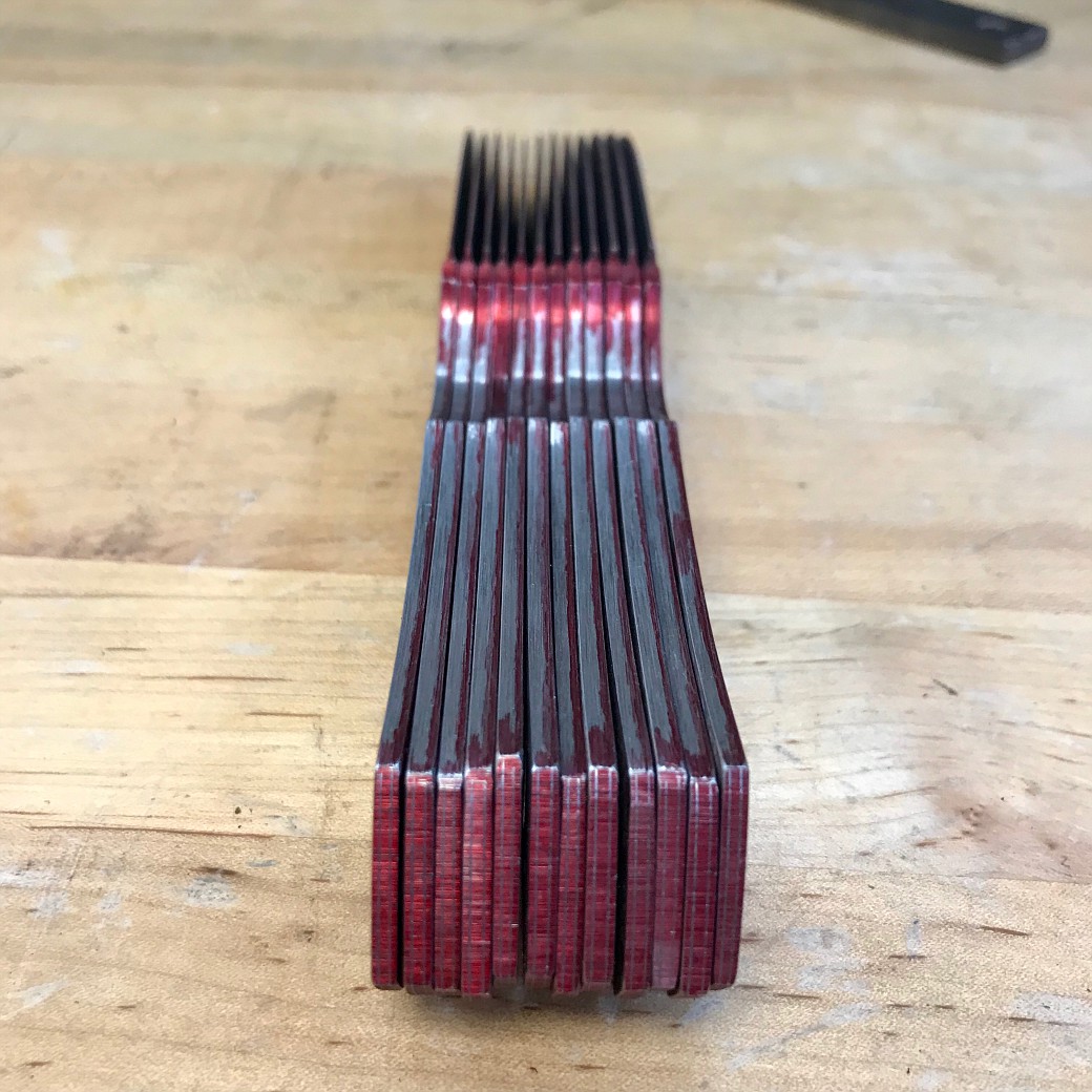

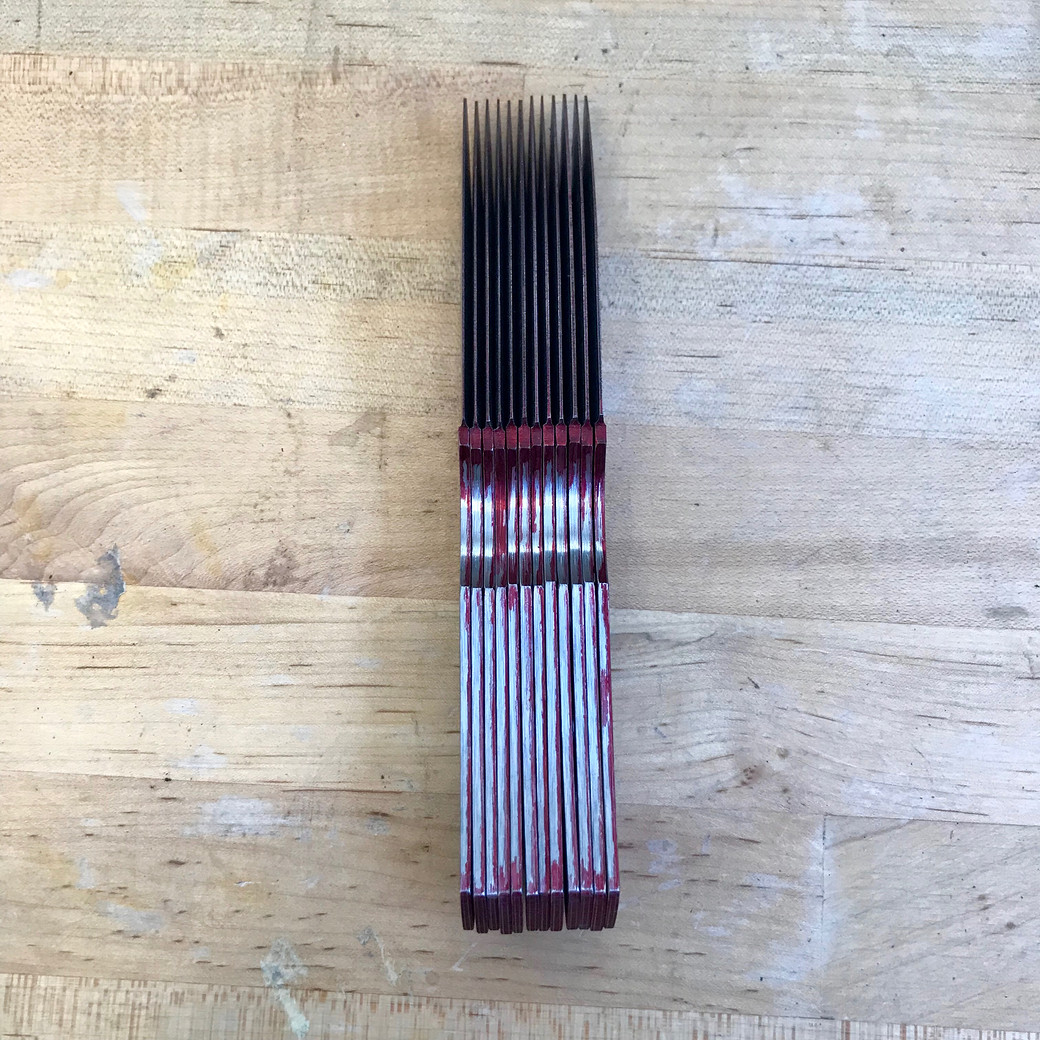

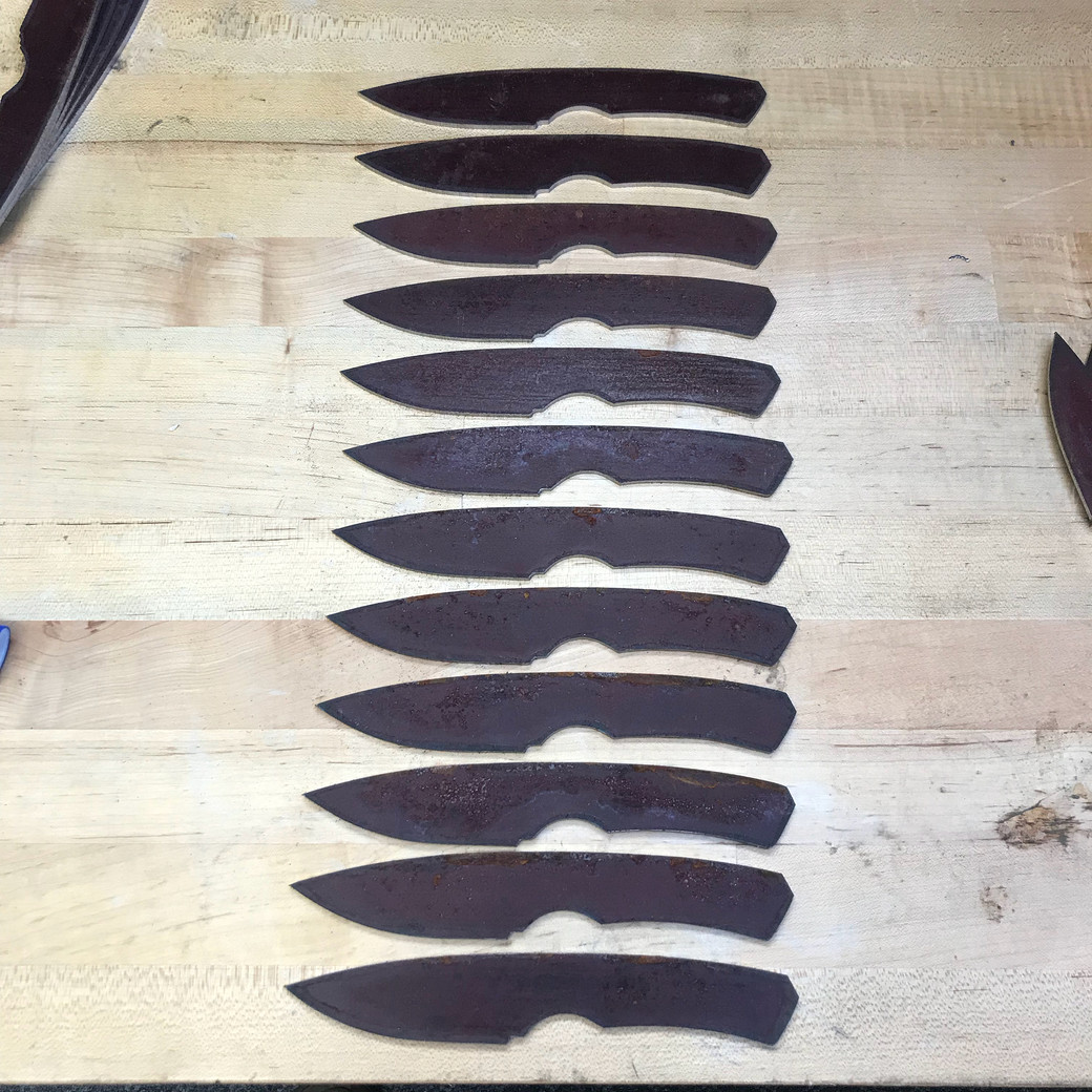

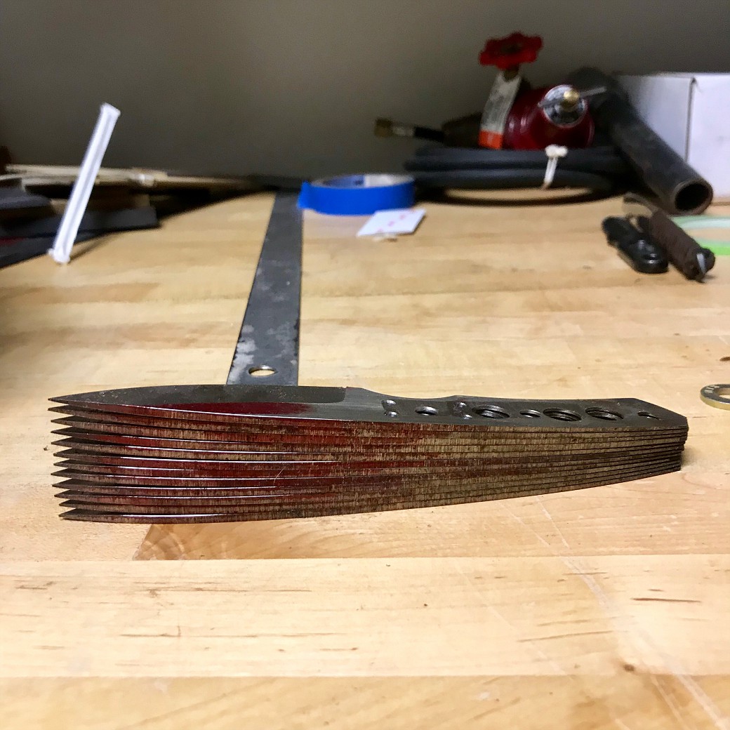

Scribed out and cut ready for profiling.

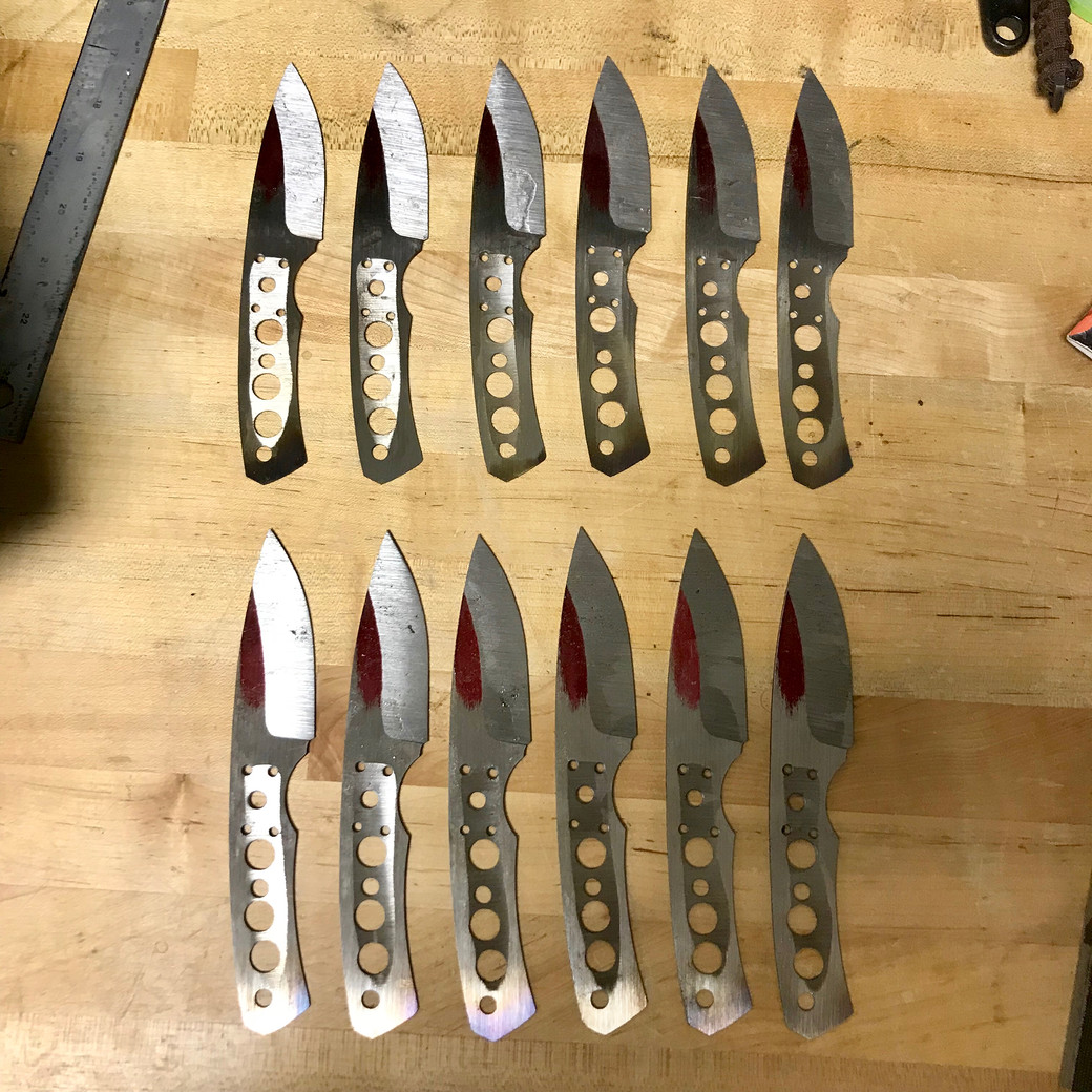

Profiled out and the profiles cleaned up to ensure uniformity.

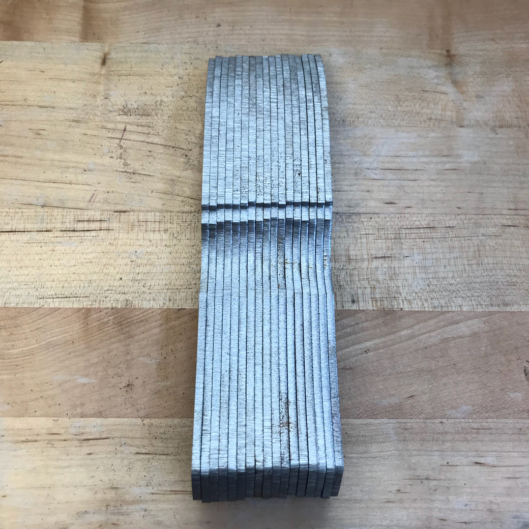

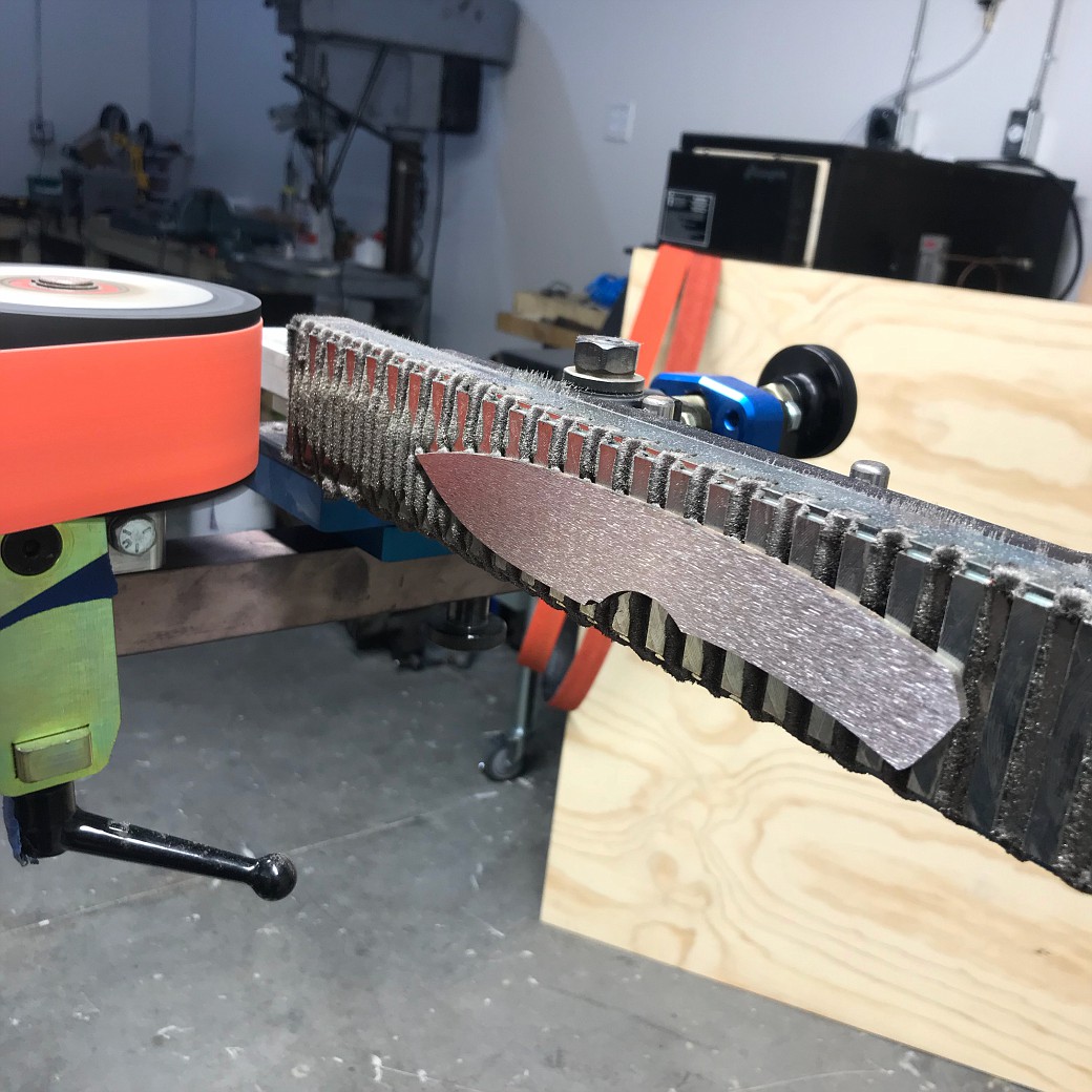

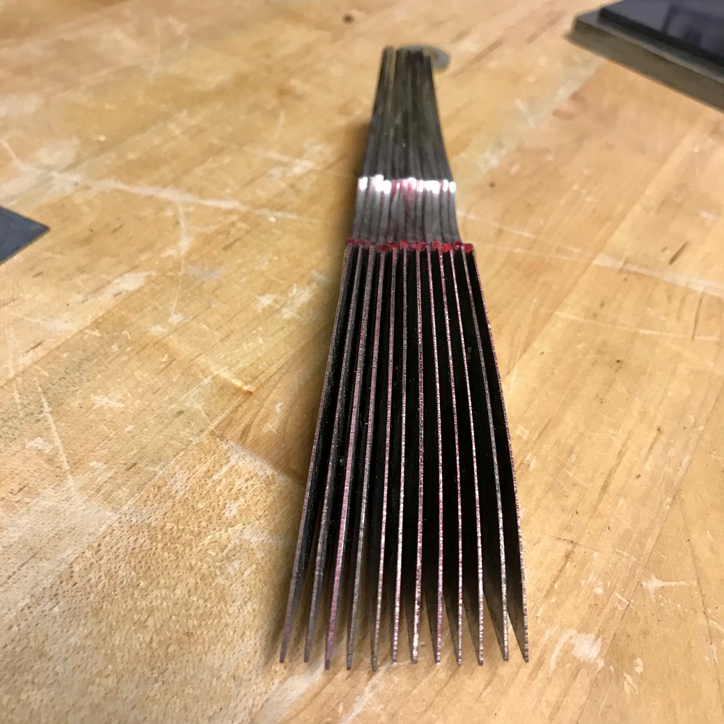

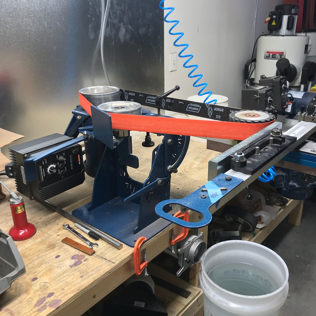

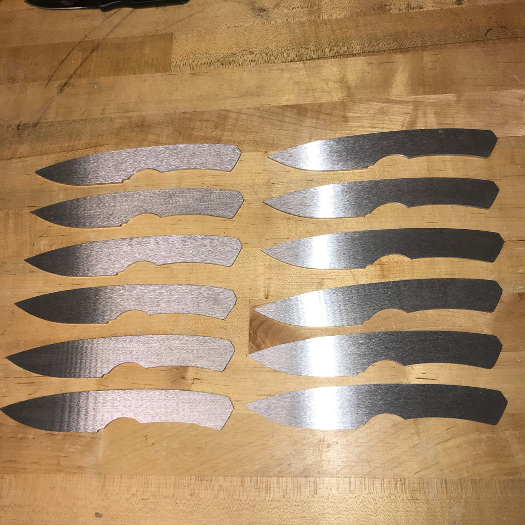

Here I am incorporating a new process into my routine, tilt the TW90 sideways and surface grind the mill scale off. I am hoping this cuts down on my production time and makes hand sanding the flats prior to hammer texturing and heat treating easier on me
Here is a video of the surface grinder attachment in action.

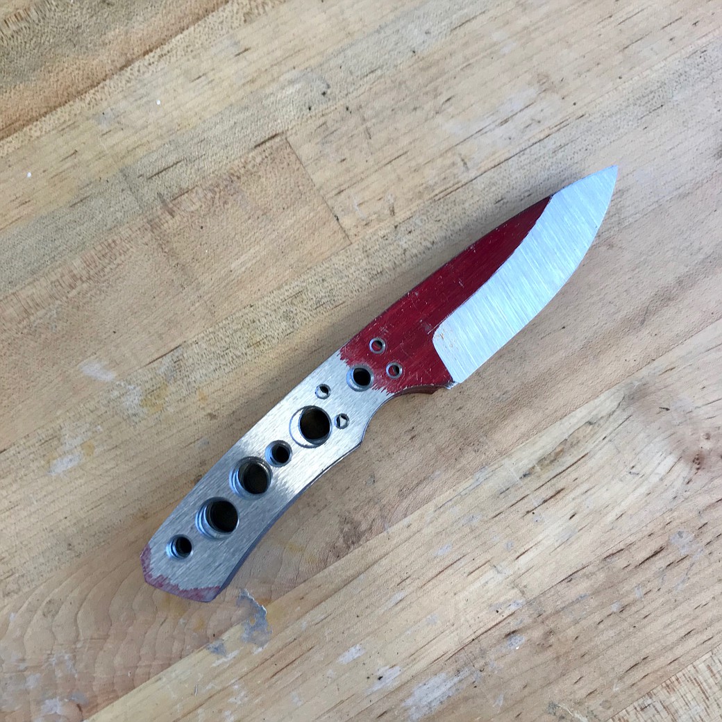

And after it has been surface ground

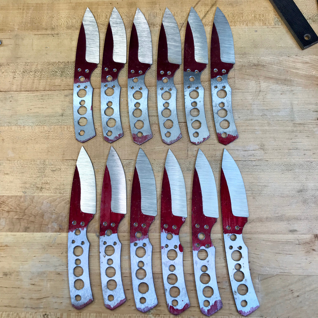

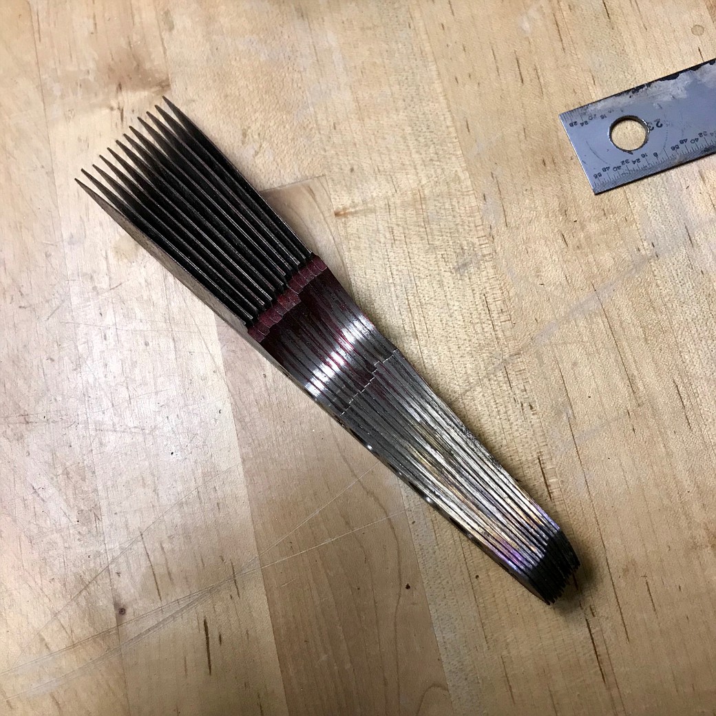

All of them at this point have been surface ground

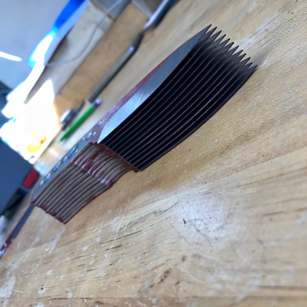

Next I will put Dykem on these scribe the bevels to about 25 thousandths, and scribe for pin layout and tapers
