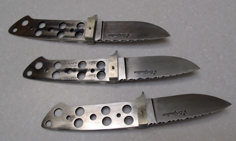

I usually grind a notch for the guard, and then secure it with only one pin and solder. . . like below:
Mike L.
