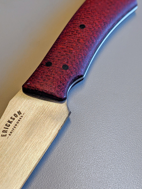

Also, it's a bit easier to make by hand because the radius of the handle fits onto the wheel of my grinder, rather than requiring a variety of tools to get into the smaller radius of a guard.
Here's an EDC I will be finishing up in the next few weeks which also reflects my evolving take on guards:
