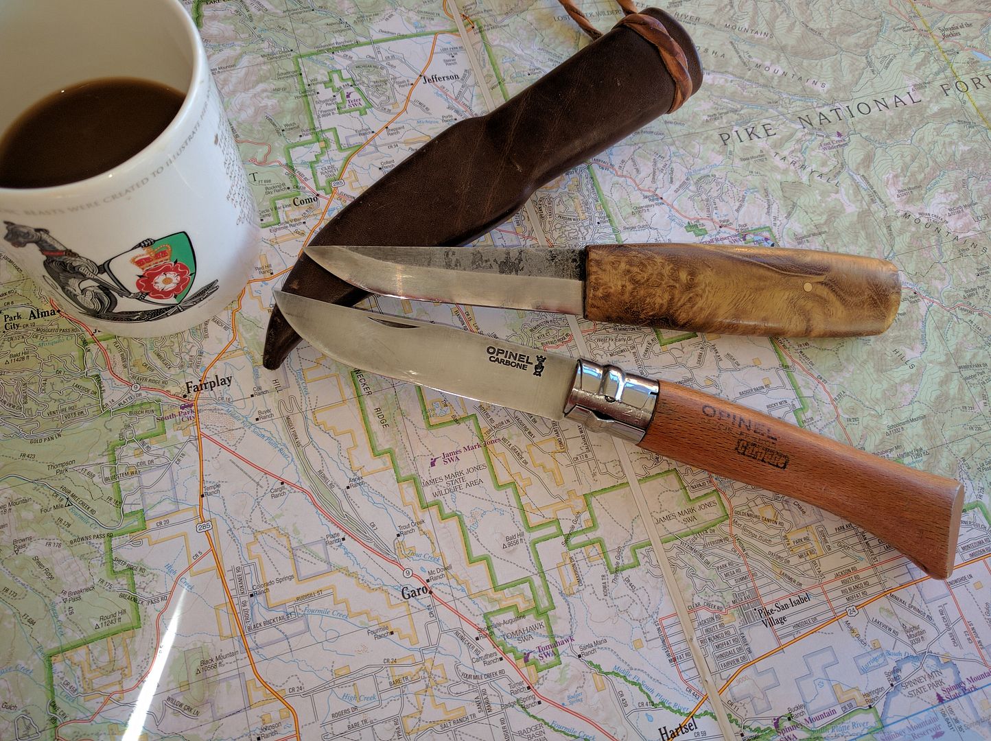

As much as I try to rotate others into my edc, and as much as I love my SAK Trekker/GAK and Bucks, I keep coming back to two carbons, the Opinel N°10 and a Malanika puukko. I forced patina on the Opinel early on, boiling the blade in white vinegar until it was deep black. But I use my carry knives daily for opening bales, slicing cardboard boxes to recycling size, slicing apples, and other tasks that abrade the whole blade. The black Opinel lost its color within two days. It has reverted to this:
I've tried refreshing the forced patina, but it just doesn't keep. Now, I live in Colorado, where we max out at about 60% humidity in the rainiest seasons, and it's easy in my job to wipe a wet blade on my sleeve. So dry isn't a problem. But I think regular use is better for a keeping a carbon blade rust free than a forced patina. I also realize that before I found myself in this outdoor life as a career, I had to look for things to use my knives for and that a forced patina was in my knives' best interest.

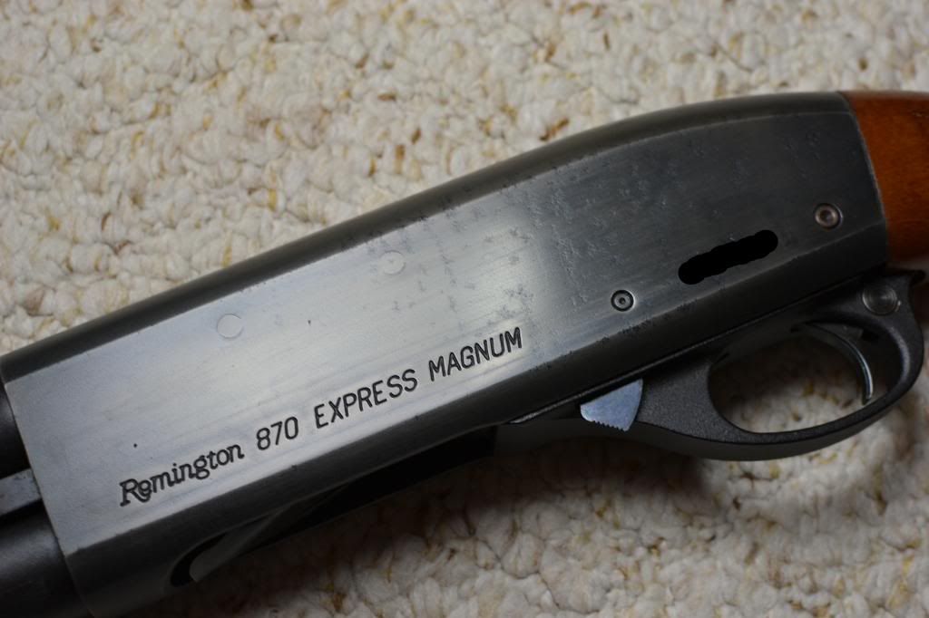

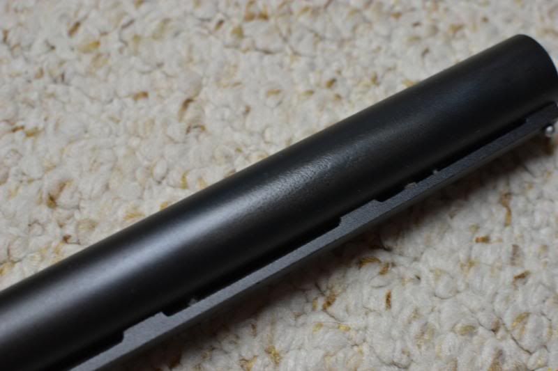

A few years back I bought got an 870 Remington shotgun for dirt cheap ($80 and it came with about $80 of ammunition) because it was left in damp case and had a lot of surface corrosion on the side of the receiver and barrel. A bit of wire brushing and some cold blue and the gun has worked like new for the past few years. Don't be afraid or rust, just take care of it when it occurs. The whole side of this receiver was red with rust. You couldn't even read the stamped model name...

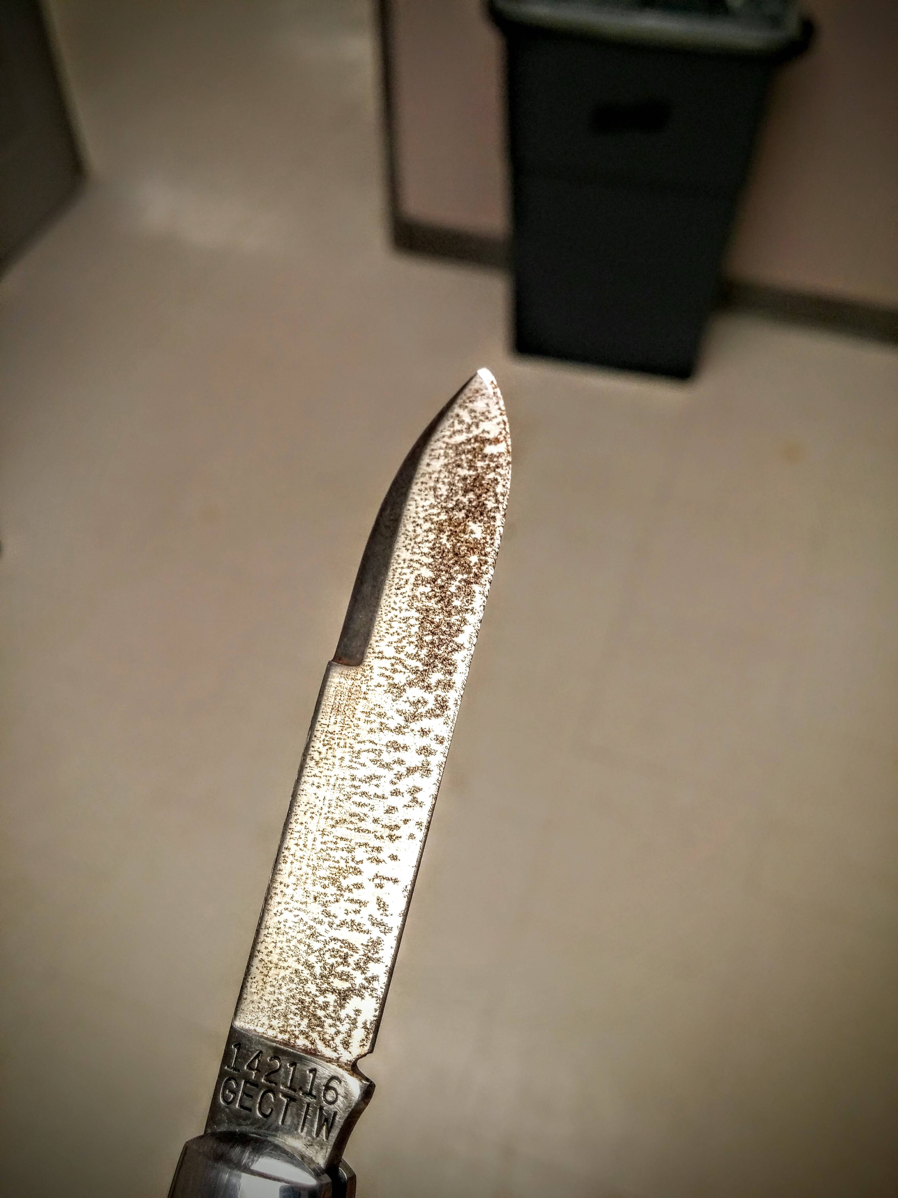

As a fellow South Louisianian, I understand all too well the effects of humidity on 1095. This is what my poor GEC 14 looked like after 3 days in my pocket working outdoors during the Summer. I just use Flitz to touch it up. My problem is more with spots that form in the well and the nail pulls/nicks. Those are a pain to take care of, in my opinion.

Thats just plain awful. Id be afraid to carry anything but stainless if my knife looked like that after just three days. And i agree about cleaning out the nail nick. Ive found that using one side of sak tweezers gets in there pretty well.

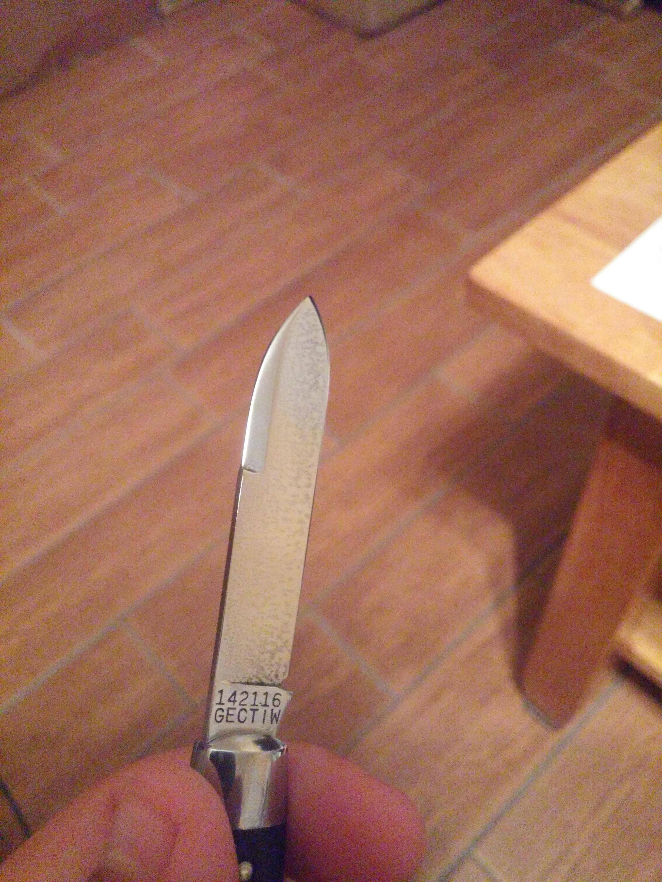

Any pics of the knife after removing the rust spots?
It's tough to get a good picture of this sort of thing using just a cell phone. You can still see where the pepper spots were after a quick Flitz polish. If I worked on it longer, it would look better, obviously. Thanks for the tip about the SAK tweezers, I'll try that.

That cleaned up pretty good though. I can understand itd go that fast in Louisiana. Im traveling through right now and its been incredibly humid these past 2 days.

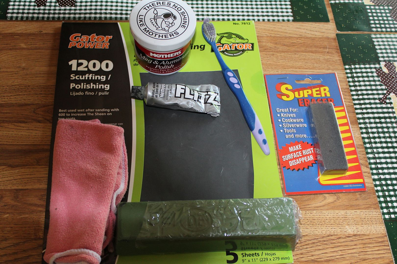

Shawn there was a thread recently about cleaning that type of rust and the OP was talking about the Super Eraser one place it's available is that South American River site. It's less than $10 so I thought what the heck at that price what have I got to loose. It works and works well. I don't like patina in most cases I like nice shiny steel so I clean and oil my knives obsessively I use a combination of Flitz and Mother's for polish I will also sand a blade with 1200 grit sandpaper if called for. Anyway just wanted to mention that Super Eraser to you.
