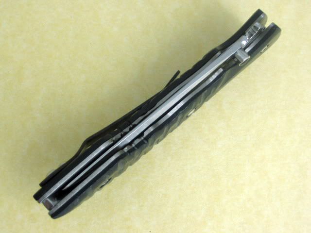

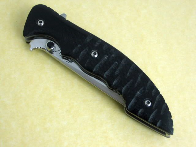

Hi all bros,
This knife I design for Randy, my master in AMOK! knife combative. The edge is chisel edge with hollow grinding. The spec is ;
Blade length 4 " ( Mirror&Satin finished ) and 1/8" thickness.
Opened length 9 "
Blade steel ATS-34, 60.4Rc.
Handle mat. - Black G10 textured
Locking system - Liner and very solid ( 100% opposite the blade )
Liner&Spacer - 6AL 4V titanium and checker .
Pivot - Hardened SKD11(D2) dia. 1/4" with SS screws detent.
Washer - Teflon ( Smooth opened )
Thumbstud -SS and ebony wood inlay
Clip - Custom hardened 6AL 4V titanium
Thanks for looking and comments
Yun
