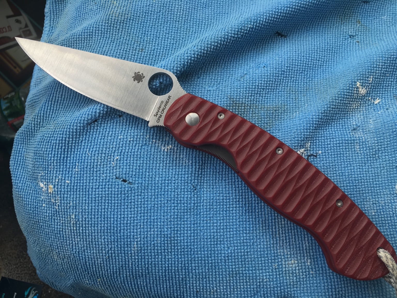

I have a Millie and a Manix in Cruwear and I'd have to say it is one of my top 3 steels.
I am a noob sharpener and I can easily get Cruwear screaming sharp!
Great steel that won't disappoint!

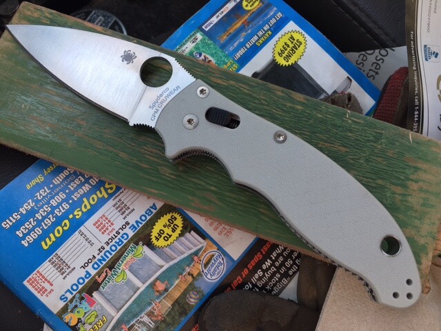

I wouldn't believe this guy saying he's a noob sharpener! I have a car seat to prove it!
^^^^^ OOOOOOPS!!!!
[emoji12][emoji12]
Knife porn is good!!! Put A Putman scales on the Millie......the light gray scales get filthy if you look at them!!
Joe

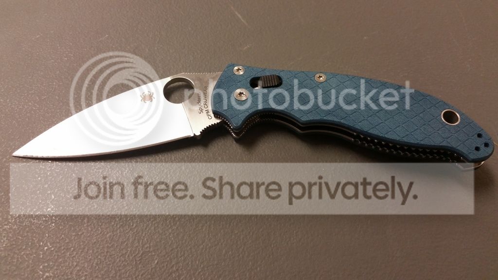

Or dye them!
They grey takes RIT Dye nicely.
Stock Gray diamond G10 dyed RIT Teal:
WO!! That looks great Bill!!

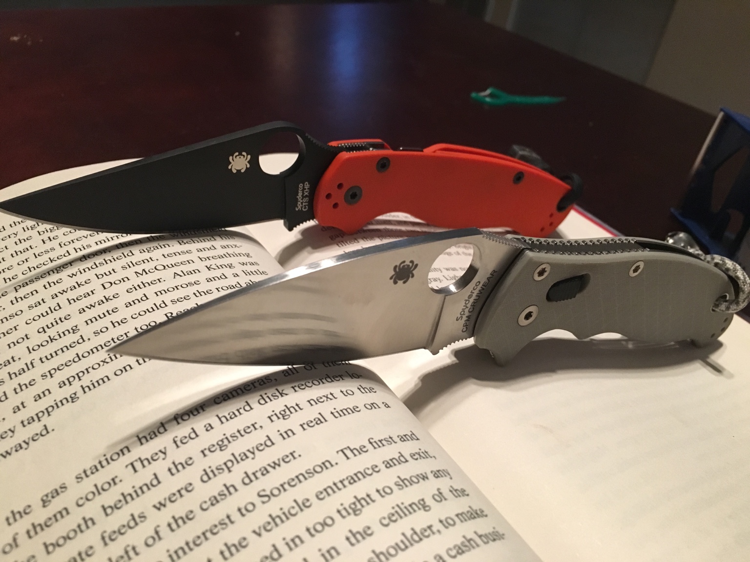

I'm guessing the orange one is a PM2? It's one sexy looking blade!

Thanks! I am going to give it another month or two and dye it again, I think I want a bit richer tone to it.
That photo was taken after about a month of carry.
