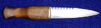

Another teaser by way of reporting progress. No guys, that's not a knife you're looking at, it actually is the finished wooden model of handle style #2. Since the blades are all the same, I'll grind one of those tomorrow, and try to finish up the model for the thistle shape #3 handle. Got to briefly pause progress tomorrow evening so I can teach a woodworking class of all silly things. ;)

number 2 is looking better and better...#3 is pretty, but no.2 looks more functional, IMHO.

I have to admit number three is a neat shape .
As a separate issue doesn,t a thistle have a textured surface ? Perhaps some cross hatching on the rounded inner section would be neat and functional as well .
