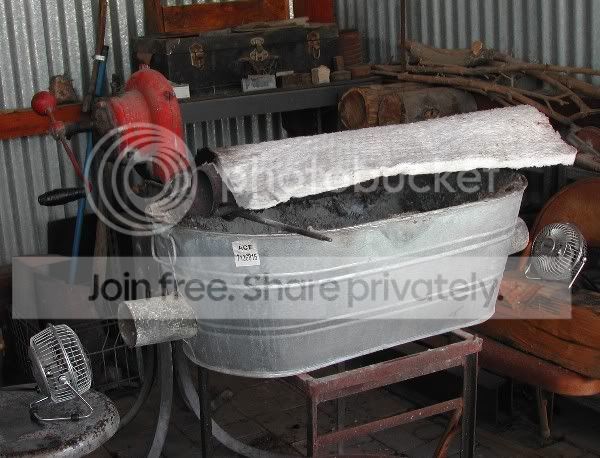

I have a gas (for small blades) and a triple tuyere charcoal set up for longer stuff.
Could you possibly post a picture of your charcoal setup? Sorry if this bugs anybody. I didn't mean to hijack this thread.
Here's what the triple tuyere charcoal set up looks like. The lining is wood ash.

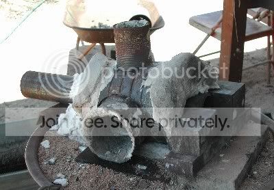

Here's the little gas muffle furnace, minus the weed burner. The weed burner doesn't go inside the side hole, but stays back a few inches and just blows in.
Tai,
I love your fancy blowers on your triple tyeure. Is that all you are using or are those for other purposes???
Chuck, I use the two little fans and the hand crank blower, but once the heat evens out it's mostly just the drafts. The fans and blower just help give a bit more control. When doing the integrals for example, the bolster acts like a heat sink and the point tends to heat up much faster than the area nearest the bolster. So what I do is preheat the tang and bolster a little with the small gas furnace and then go into the charcoal furnace. I run it with a heat gradient at first, so it's a little hotter at the bolster area, by using one of the little fans, so whole blade heats up at a more even rate. Then it's mostly just using the drafts for a nice even soak. It makes judging soak times on the integrals a bit easier and is less likely to warp the blade while it's heating up.
Another nice thing about the ash lining and triple tuyere is that I can use one, two or three depending on the size of the blade and conform the ash to fit what ever size I want. This one is set up for about a 16 inch blade maximum not counting the tang.
I end up moving the fans closer and further, turning them off and on and using the central blower to help control the heating and soaking. It probably sounds difficult and looks a bit goofy, but with some practice it's really not hard to do and works great! :)
I guess I should add that I can easily get a 10-12 inch blade with just the central tuyere. However, if the blade gets much longer than that the heat slopes off at the ends. That's where the other two tuyeres come in.
