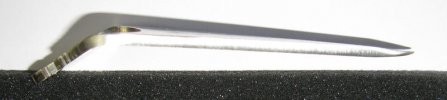

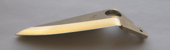

Sal asked me to share a few pics of a Pacific Salt blade we recently did some testing on... :eek::D

That's certainly a bit of destructive testing there :eek: Interesting that it bent so far with such minimal fracturing.
