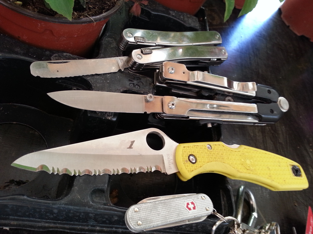

For some color variation.
more today! The best serration patterns for ease of sharpening and tolerance to abuse: Spyderco and Victorinox
