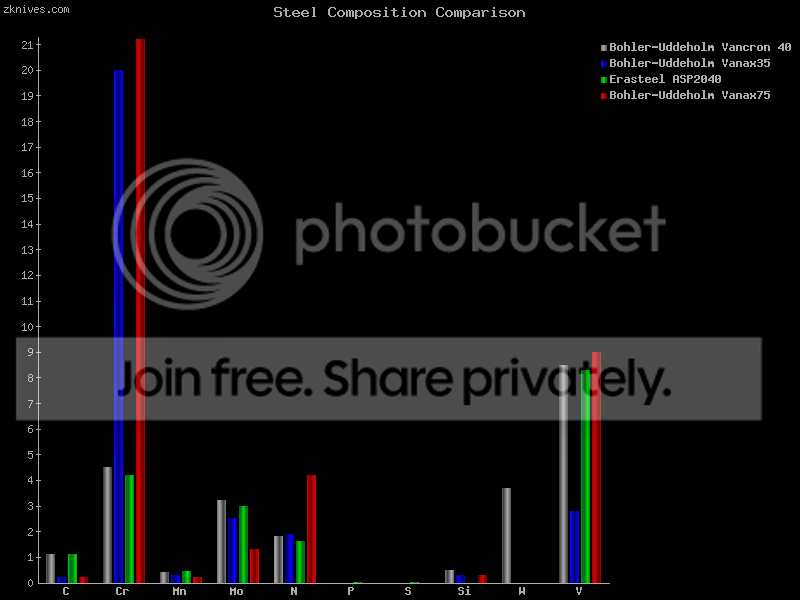

This pretty much describes Vanax 75 (used in the Kershaw Tilt).
I don't know if it's "rust proof", but it is a Nitrogen alloy (with 9% Vanadium:eek:) so it'll be pretty good.
I still wonder if Carpenter steel does Nitrogen alloys, if so they could probably mix up an equivalent for a sprint run.

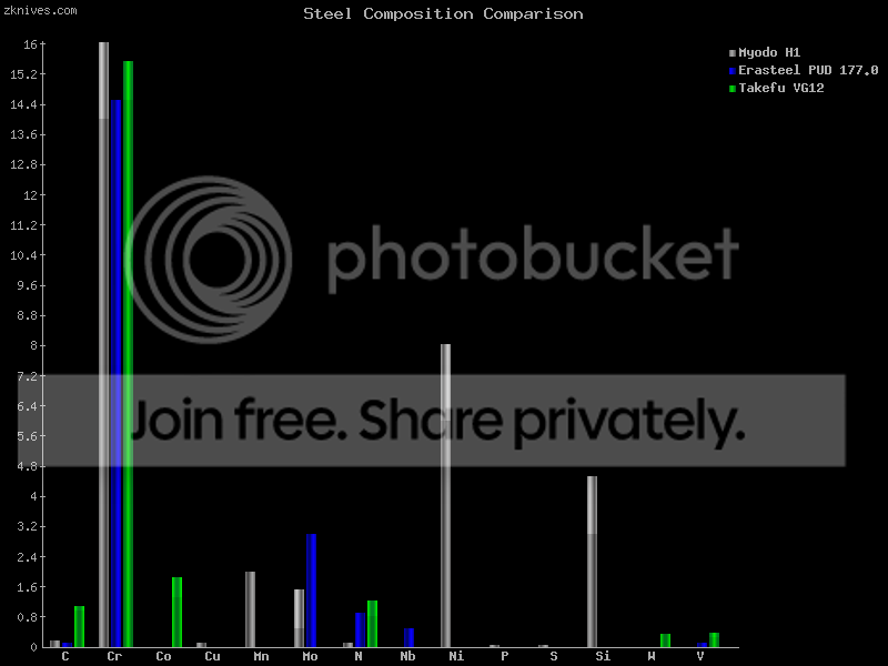

I was thinking it might be nice to have a PM version of H1 with a high carbide volume (with small carbides and a fine grain from the PM process)
I was under the impression that H1 was already a particle/powder metal (not a steel, technically).
Correct me if I am wrong, but does not all of the base of all alloys are Iron (Fe) or "raw steel",from there different transition metals are added, in this case, some non metals. These create alloys.
http://www.ptable.com/
Here are some comparisons.
The "traditional" definition of steel, was an iron alloy with a certain minimum amount of carbon in it, IIRC H1 is just below that line. A mere technicality, but would be nice to get the final word on that someday. In regards to the OP, first thing that came to mind were Vanax 35 and 75. I don't know if they have the same interesting "work hardening" ability of H1, and I imagine their ultimate rust resistance won't quite match up. Vanax35 might be close though.
