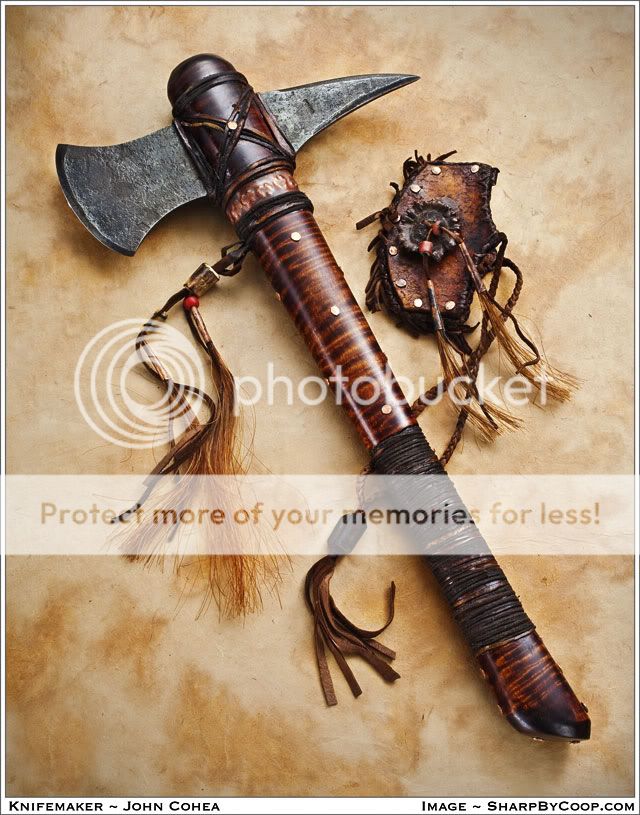

Here's a couple of mine made as you are talking about. These are real popular for me right now, and the second one was just featured in an article in the Sept. issue of Blade magazine!I mount my heads by drilling a slot in the haft while the stock is square. I drill the slot undersize then heat the spike end of the head and burn it the rest of the way through from the front side of the haft. Once the haft is shaped, head heat treated, ect, the head is pinned in place with 4 steel pins, then wrapped in wet rawhide lace in a way that the pins are hidden from view. Hope this helps!

Thanks Robin for the compliments! As Robin noted, his method of construction (two piece haft) would handle little totque Mine would be more likely to handle torque due to the construction being more solid.The way I burn the head into the haft makes for a tight fit, then the four steel pins and the way the wet rawhide shrinks around the head and haft makes for a very solid unit.I test these things by chopping seasoned oak logs, with absolutely no movement of the head.These things are pretty to look at, but make no mistake about it, they are a 100% functional tool/weapon!

I am currently using late model Ford truck leaf springs, and they are usually around 3/8" thick. I start with a 7" length, upset the blade end and then widen, then I draw down the spike end leaving the middle as is. I usually shoot for a head length of around 9" with a 3 to 4 inch wide cutting edge.
