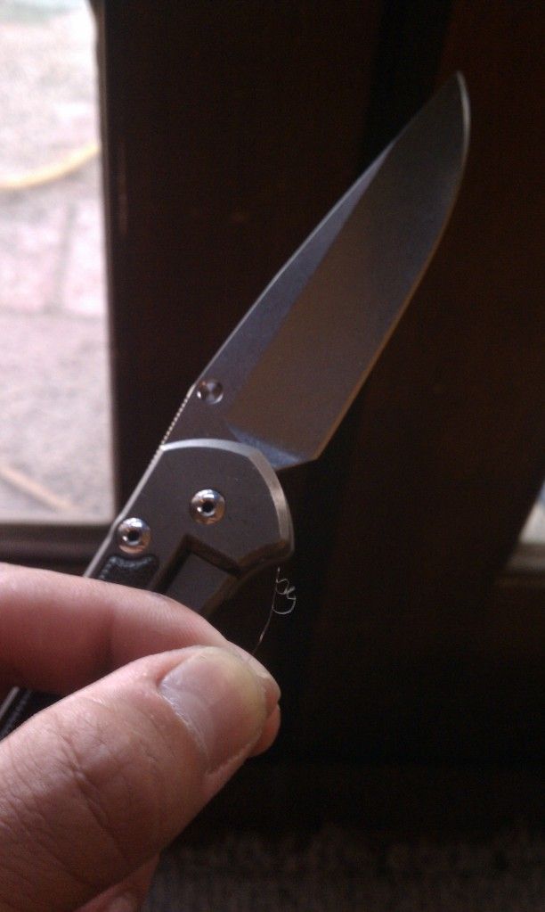

So couple questions to those well versed on this subject matter, and those that purport to be....
1) Is an edge that splits hair restricted by any certain geometry?....<30 inclusive...etc....
2) Is an edge that splits hair restricted by a certain level of polish?....stropped at XXmicrons...etc..
3) Is this edge suitible for EDC, like opening things made of cardboard, plastic and flesh?? Or does such an edge prove too fragile for said events?
Questions submitted respectfully on this great day.

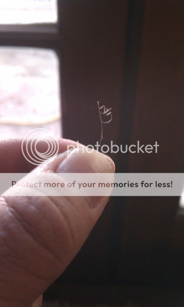

Heres a hair splitting edge I just put on my Sebenza last night. 40 inclusive. Went up to 1,000 grit diamond and than hit it with the 3.5 and 5 micron strop.
It is not a mirror edge and actually has a good bit of bite to it. Its a very clean edge though with not a burr in sight.
This my experience. Hair splitting is a lot easier to achieve with a smaller inclusive angle. Its also a lot easier to achieve as you go farther up in grit count. If its going to split with a simple push as opposed to using a bit of draw then it will most likely have to be very well refined at the apex. In many cases when stropping its possible to get a high degree of uniformity at the cutting edge but have a bevel that still shows some grind texture. Its plenty suitable for EDU, but in my experience, with common steels, loose the ability to chop hairs very quickly and require a lot of maintenance to stay effective. This maintenance might take only a few minutes several times a week but without it the edge will degrade fairly quickly compared to a less uniform apex produced at a lower grit. Its a good endeavor for improving your sharpening skills and works great for some tasks, but for low-maintenance EDU not very efficient.
