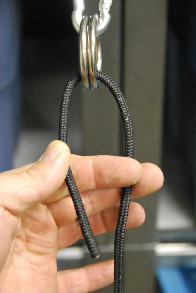

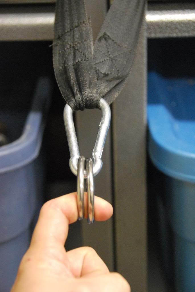

Can you point me to the set-up method with carabiners? I have a Hennessy Explorer deluxe with the Hex fly and have not even had a chance to set it up yet.

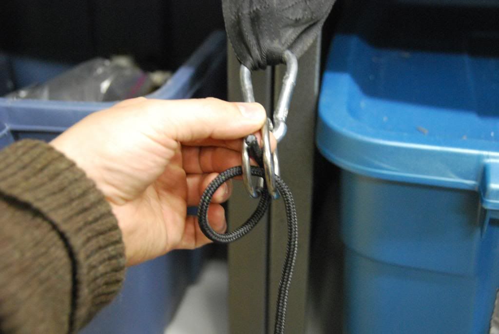

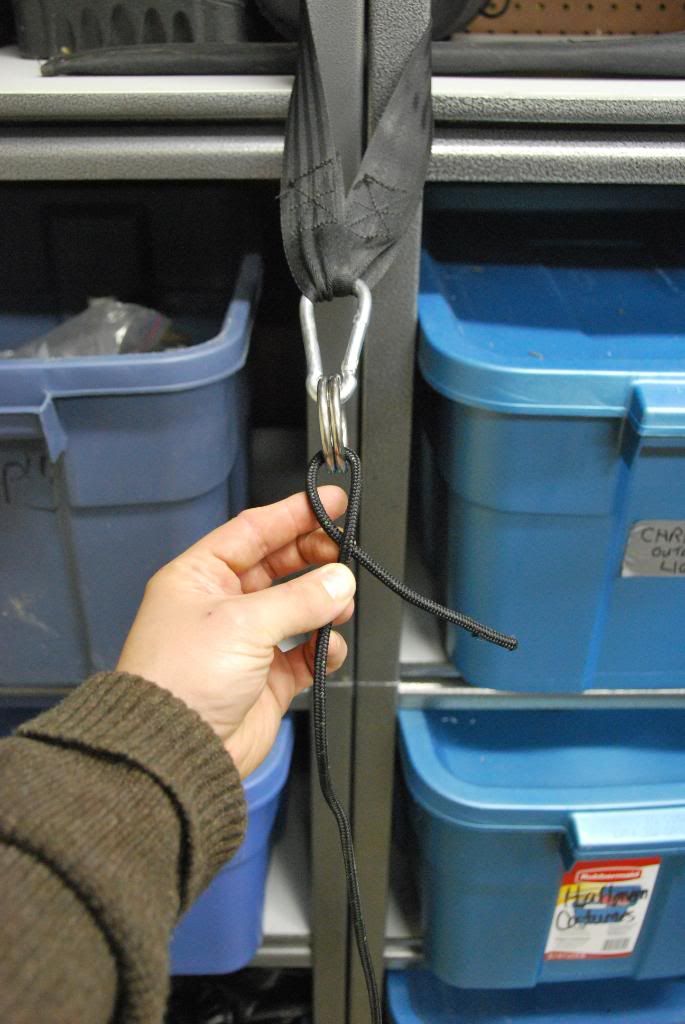

A long time ago I did a pictorial thread on it...I remember learning it from a youtube video but can't remember it either. Here's my pictures dug up way back in photobucket.

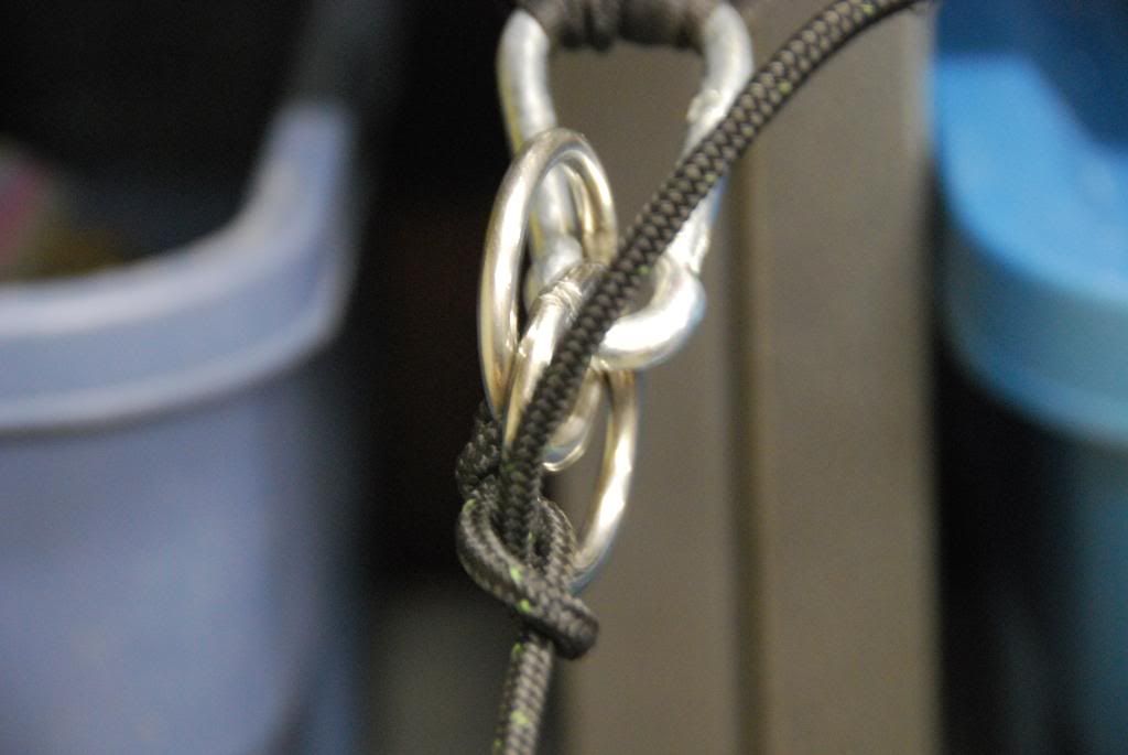

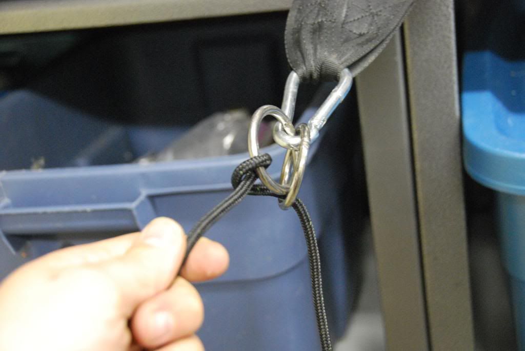

At this point, give the line a yank
Now you can easily self adjust the tension by simply pulling the free cord. Tie up the other end of the hammock and adjust each end to center the hammock between the trees and apply good tension. Once you have found the right tension and position lock it in with a single square knot.

The tie as shown is a bit different than what I use. I go thru both rings once, loop around and go just thru the first ring, or in between rings. The ropes can now be adjusted longer or shorter as needed with just a pull. When the proper length or tension is found, go around thru both rings one more time and secure with a half hitch or two. I have a mess of a time when it comes to knots but this is so amazingly simple you can do it one handed or even with your eyes shut.
