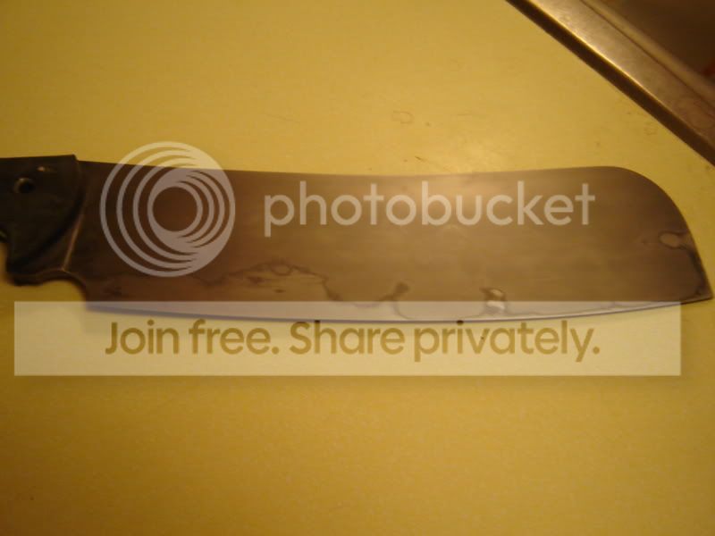

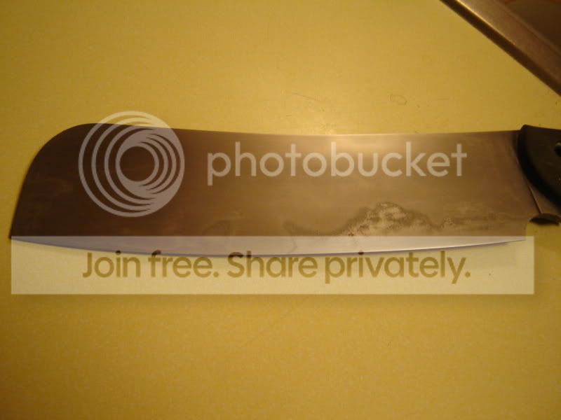

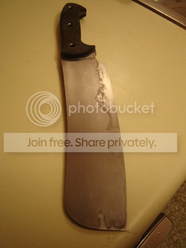

I hesitated at posting this at first because I was somewhat ashamed of my first attempt at producing a hamon. I am going to suck up that shame however for the sake of learning for all of the would be hamon makers on the forum. I've spoken with a few of what I consider to be the "pros" at this stuff and am eager to give it another go. A little bit of backround info so that you know what I started with and how it DIDN'T work: Blade is 1095. 1/4" thick at the spine. Full flat ground and I left approx 1/8" on the edge in order to do a convex after all is said and done. Blade is 10" from handle to top edge and approx 2.75" wide. After rough finish I used furnace cement as a "clay" and applied it about half way down the blade surface in a wavy pattern that I thought would start the hamon line well. I let that stuff dry overnight and then it was on to heat treat. This is where things went downhill, although I didn't have a clue at this point. The heat treat seemed to go well. Ran up the oven to 1475 for 10 minutes and then quenched in oil. The cement held on but seemed to bubble a bit during quench. After initial cooling, the cement broke off real easy and I had what looked to be a really nice start to a differentially treated blade. The steel under the cement looked virtually untouched and the exposed steel had all the scaling and blackness I usually see on just quenched steel. (On a side note, the smoke build up in Ken's shop was unreal at this point. When we cracked the door I'm sure the neighbors thought there were some rastafarians having a good time in there.) When I got home, I cleaned up the blade initally with some 220 grit and I could see some grain patterns right along the line where the cement was. Good news I thought. I ran a file over the spine and it was soft and it skated over the edge so I thought I was in business. (I also learned during this experiment not to trust the file test on a differentially treated blade...you'll see why) I tempered the blade at 400 for 1.5 hours twice. It got to that nice straw brown color both times so again I thought "this is too easy". After temper, I sanded off the scale and such with a hand belt sander and got it back to "white steel" (a Matt Lamey expression) and proceeded to run up the grits in different directions all the way to 400 lengthwise. At this point I was starting to see some really shiny areas around the choil and the top edge of the blade. This is when I started to have my doubts that the hamon was where I wanted it to be. It's kind of hard to describe the areas other than that they seem to shine up just a little more than the rest of the blade. (I'm sure the pros know what I am talking about here) Anyway, I kind of shrugged it off and thought that it must be just some strange metalurgic thing that my jarhead brain can't comprehend so I moved on to attaching the handles and getting them all cleaned up. I used rubber for these BTW and I LOVE this stuff. So now the blade was good to go and ready for etching. I filled a 4" wide x 2' long PVC pipe with vinegar and set a space heater next to it to warm it up and dunked the blade in hoping for the best. (mind you, at this point I was still somewhat confident in myself...lol) 2.5 hours later I pulled the blade out and neutralized with windex and went on to polishing with chrome polish. Well, this is where the "oh crap" set in and I realized just how much of a novice I really am. Here are some pics of the result:
You can probably see where the cement was and how far the hamon got "pushed". There is actually a very thin line of martensite running all along the whole edge except for one spot right in the middle of the blade. (probably why the file skated....and why I don't trust that method anymore) Anyway, I've sought out some pros and appealed to their greater knowledge and I have some things that I am going to try and do correctly this time around and try to fix this one. Hopefully, this wasn't too long winded but like I said, I am hoping that some newbies like me benefit from my mishap...plus I needed to vent a little frustration. Thanks to Stacy Apelt, Matt Lamey, and Chuck Richards for their patience in answering my questions and to Ken Coats who will have to endure more of my knifemaking experimentation in the future. On the plus side, the hamon does "pop"....

What kind of oil are you quenching in? I may have missed that. My guess is too thick of clay, too slow of a quenchant.
Those are the theories that have been suggested. I'm going to try the brine solution that Stacy suggested and pray I don't end up with a cracked blade. Not really sure what Ken uses as a quench oil but I would gather it's too slow for hamon work on 1095. We also quenched "tip" down and straight in. Stacy suggested I do it edge in which I imagine will have a significantly different effect. Also, I had no idea about the "down for 3 up for 3 and down to cool" method. What I find strange, is that the area closer to the choil ended up retaining more martensite. That area would have been later into the quench and also at a higher temperature in the tank than the area closer to the top of the blade. You would think that the top would have a wider "hard" area.

At this point, I don't want to give up even if it results in a destroyed blade. Since I don't yet have my own heat treat set-up this will probably be the last one I try for a while. I don't want to push my luck with Ken's patience and I have other projects that require my attention as well. I just wanted to push forward into what I consider a really interesting part of knife making. Not that there is anything wrong with a fully treated blade, (I will still make many of those) there's just something about a blade with that sweet flame pattern of the hamon that just sings to me. Plus, you gotta admit that if it works, this will make a really sweet looking chopper. Ken and I were just saying that I have had too much good luck so far with my blades and I am bound to have a failure about now. I'm hoping that the first hamon attempt satisfies Murphy's law for the time being but I have a feeling that I will be a proud member of the ping club pretty soon. This has really jump started my motivation as of late though. I really want to get this to work so that I can say that I've accomplished it and now it's time to have fun with it. It's kind of like my first blade, it was sooo much work but once it was done I knew that it could be done and now grinding out a knife isn't nearly the ordeal that I used to think it was. We'll just have to see how this one turns out the second time around.
Get yourself some Tuff Quinch from Texaco or some of the Parks quinch oil. I use Tuff Quinch, warmed to about 120+/-.
The design on that knife is very nice, one thing you can always do if you dont get enough conversion is to simply re heat the blade and re quinch. If you are running lines of clay down to the edge, lighten them up a bit, or just stay completely off the edge. Always try for at least 1/4 of the blade (up the edge) to harden, especially on a chopper.

I am no expert. From what I can tell it looks like alot of heat was heald in the clay. The steel didn't cool as quick as it should have. With great info from Don and others I found that the clay doesn't have to be very thick at all. I went to about 1/8" and have gotten good results. I do use Parks #50 quinch oil. Also found I get better results if I do a quick edge quinch (3 count then out for 3 then submerge the intire blade and let cool.

I know of two things that will push the hamon down to the edge like that. blade thickness and how heavy the clay is applied. from reading your posts it sound like both are at work here. I am however no Don Hansen the hamon super hero.
