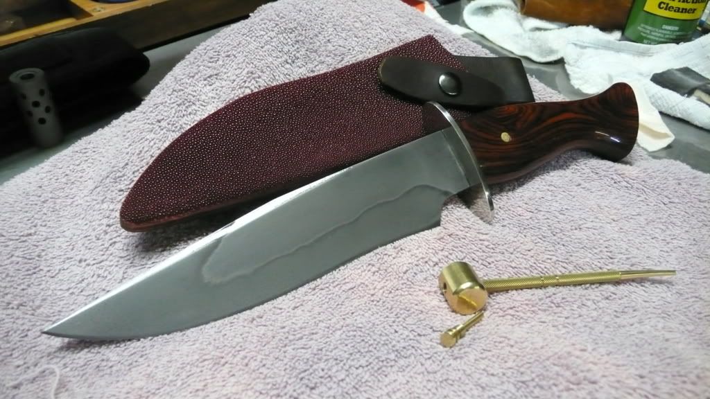

When they say polishing a sword will bring out the temper line (Hamon) this does not mean using flitz or metal polish like mothers
These polishes will obscure the Hamon to a certain degree
I am sure if it says that the blade is differentially hardened it is to a certain degree but in a relatively inexpensive piece I would not be setting my sights to high
If you want to bring out the temper line the quickest way for you to do so would be to etch it with some ferric chloride
You can get it at Radio Shack. It is used to etch computer boards
This is an acid
It needs to be done outside or in a well ventilated area
You should wear rubber gloves
Pour solution in a plastic or glass container and since you will not have enough to dip the entire sword dip the tip in and use a paint brush to draw the fluid up the blade
I like to mix the enchant with hot water even a 50 50 mix will work
Dwell time will depend on the desired effect
The blade will turn blackish
Rinse the blade in water and wipe down with a mixture of water and baking soda to neutralize the acid
Here is the tricky part
Take some flitz and gently Hugo over the blade till the desired results
Remember you can polish it right off again
These are caustic chemicals do not breath in and be careful how you dispose off
To be honest on a hundred dollar sword I would not bother. Not trying to be negative just honest
Here is Shiva Ki blade that was flitzed and the Hamon was obscured
Here it is after retching and light polish
