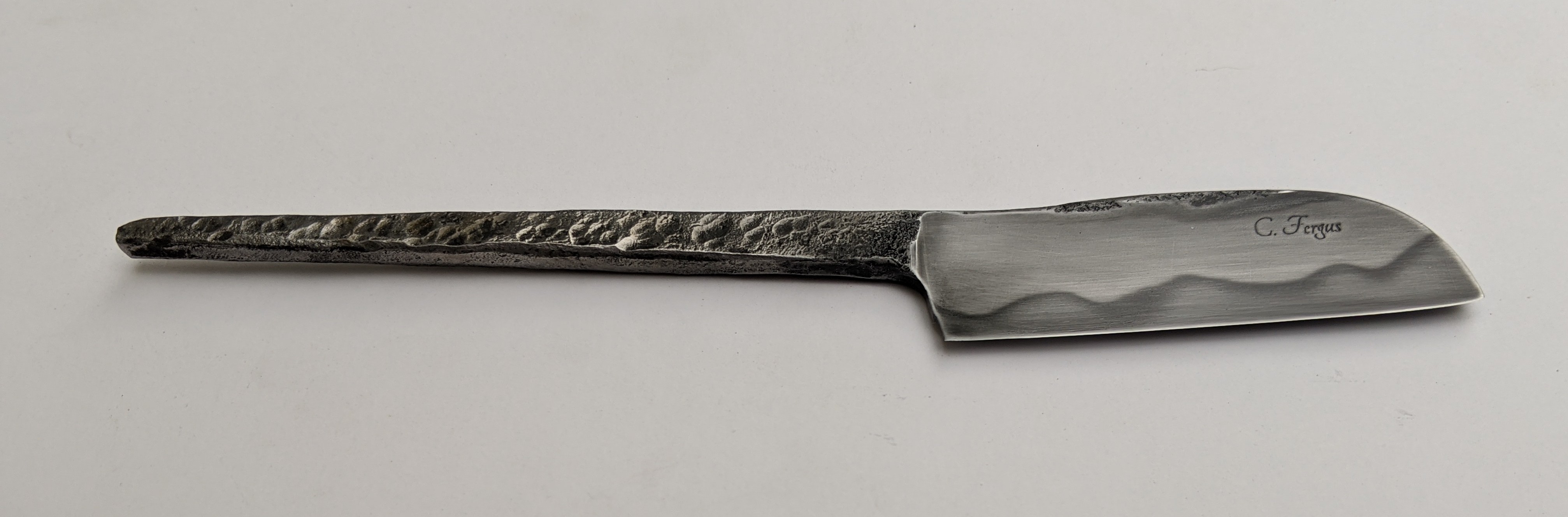

I used a vertical quench, no problem. Stock was 0.120" thick 26C3.
I ground the bevel before heat treat, maybe reducing thickness to 0.08".
The line is exactly where the clay was applied (rutland's black furnace cement).
