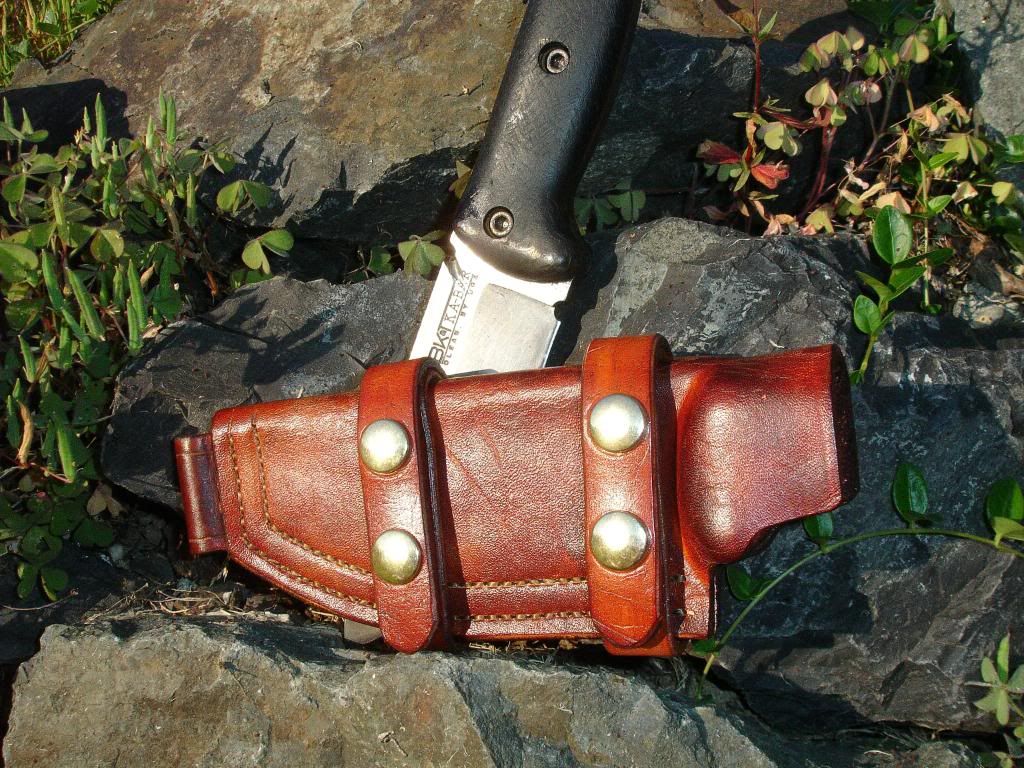

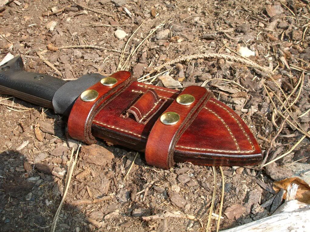

Who else does all their leather sewing by hand? I'm just a part time hobbyist so I really have no use for a machine; though it would be nice sometimes.
4 layers of 8-9oz on the top welt.

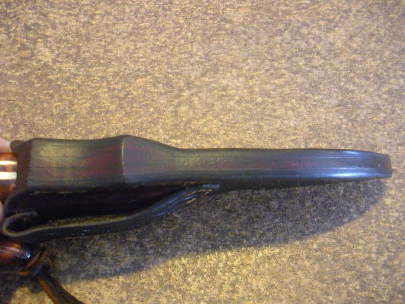

A quick PS: Those really thick layered sheaths as in post #10.....there are several neat ways to get around that without much trouble, but that's another topic. My phone is always available if you are curious.
