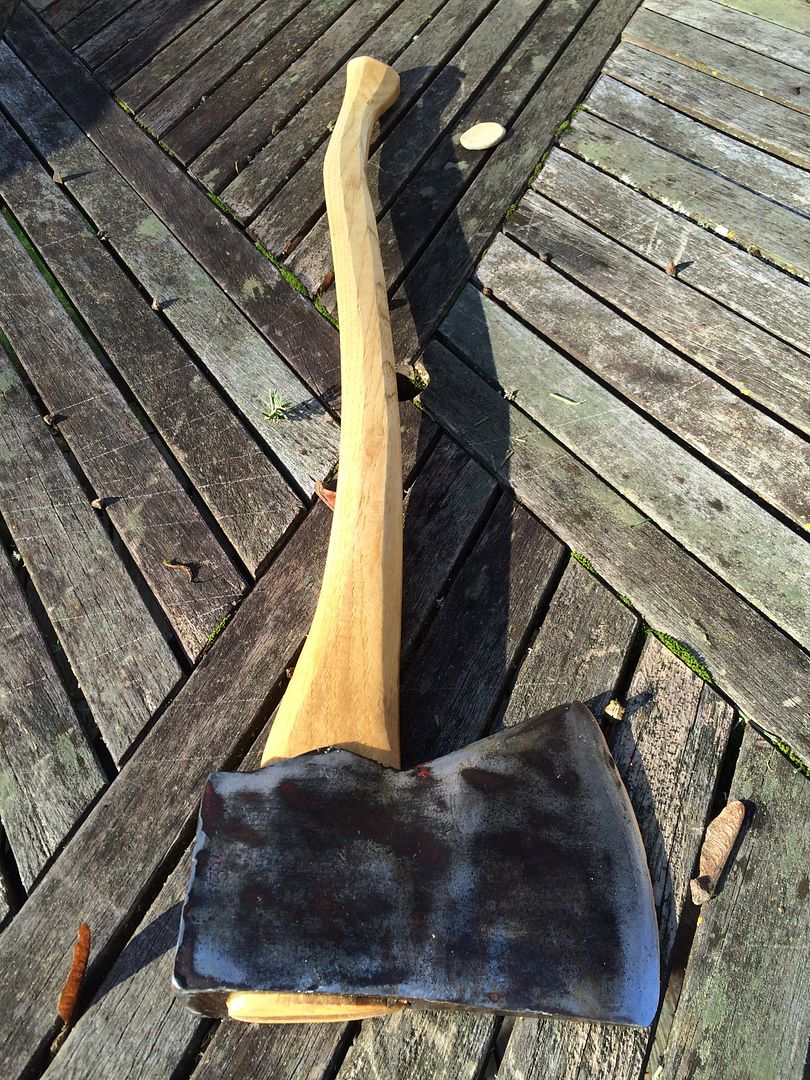

So, i bought a true temper kelly perfect today, but i need help deciding on a handle, straight or curved? In my area, i can only buy curved handles, so take into consideration i'd have to get a custom handle, or i'd buy it off the internet, but I'd really rather not buy a handle i cant see first, quite a few things could be wrong with it after all.

Agent_H, I think it's jersey pattern
Very nice. I am drawn to straight handles on certain patterns and think Jerseys look great on them but as 300six is saying above there, it is personal preference for the most part.
That isn’t to say that curved handles aren’t a good match to your Jersey pattern. This is an older picture of an unmarked head but this one gets grabbed to do chores more than others (octagonlized is optional):

Any pictures of your new project?
sure, i'll get'm to you soon, i'm a good bit away from an agri supply, they sell tenesee hickory curveds, but husqavarna's closer, and they sell the straight handles. Do they sell handles in-store?i think i might go with a straight handle just to mix up my collection a bit, even my maul has a curved handle

I looked at the picture of that axe head. Jersey patterns lend themselves to straight or lesser curved handles. As Peg says; it would be a real bonus, if by virtue of being a Perfect, that the poll was hard too.
