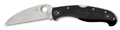

Looking for others' opinions on this little phenomenon.
I bought my first Endura a few years ago, and Endura 4 with brown handle scales. I loved it. Strong, light, slim, everything a large EDC should be. I never had a problem with it. But then one fateful day I read a post from someone somewhere, I can't remember if it was here, or the Spyderco forum or somewhere else, but this person mentioned how the handle points, or bumps were not positioned very well for his hands, and that he found them uncomfortable. I found others who said the same, and particularly mentioned that the bumps were too sharp or pointy.
Oh no! the seed of awakening was planted, and over the time, I started to notice the same thing. Eventually I ground the first bump off for a continual curve in the handle until the second bump, and this alleviated most of the hitherto unnoticed issue for me. I bought a Delica 4 Wharncliffe, and found the same treatment improved the comfort in hand on this knife for me as well.
I do not own an Endela, but have often felt that I would like the Delica blade to be just a touch longer. So the Endela is interesting to me, and I also notice that they have rounded the points in the handle as well.
So I am just wondering how others feel about these three knives, the E4, D4, and Endela, with regard to the handle bumps/points. Do you like them, hate them, or not even think about them? If you don't like them, how would you or did you mod, and what were your results?
I like my Endura 4, Delica 4, and Salt 2 better like this:
And as a slight aside, the Endura 3 handle on my Pacific Salt is way more comfy like this:
But I hired someone to make me carbon fiber scales for my E4 Wharncliffe, based on my drawing in paint.net.
He finished them and sent me this pic, and now I am expecting them in the mail (yes I did specifically ask for left side tip down carry:confused:):

Well I figured I should update this thread with my all time favourite Endura. I ordered custom carbon fiber scales for it, and the design I submitted him was a bit on the fat size, as can be seen by the pic above. That gave me the wiggle room that I knew I would need to fit it perfectly to my hand. Here is the result:
What I didn't anticipate was the nice increase I got in cutting ability going from bendy FRN to stiff carbon fiber!
